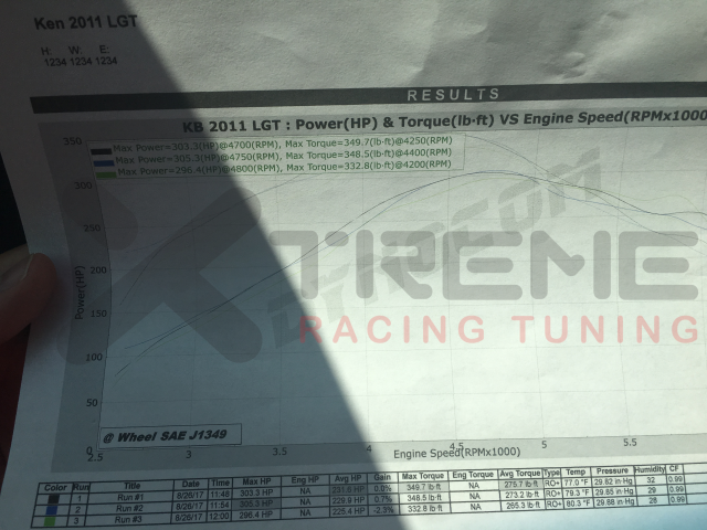

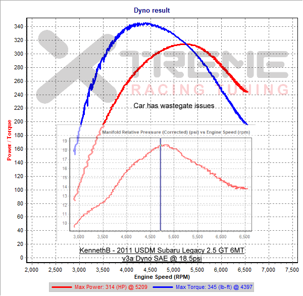

My 21psi was caused by a faulty boost controller.
The dyno that he showed was during the discovery of this issue.
We will find out what numbers I make on a actual dyno toward the end of the month.I haven’t taken the time to post due to unbelievably busy.

Sometime had passed (Like I said insanely busy) and I had took off the boost controller and cleaned it and put it back and received a new rom. I drove the car around and the timing just kept getting better and did a 3rd gear pull. (The one he posted and it had me at 21psi again. Yes it is a concern and no he is not cranking everyone up.) And it wasn’t until I tried to pass someone at WOT in 5th gear when the car threw a code again.
Ed said that he is not seeing the wastegate function properly in the logs and wanted me to take the boost controller off and give it power to see if it opens. Low and behold it doesn’t open.This is why I have been getting 21 psi boost. I have ordered a new boost controller and installed it and that has resolved the issue.
