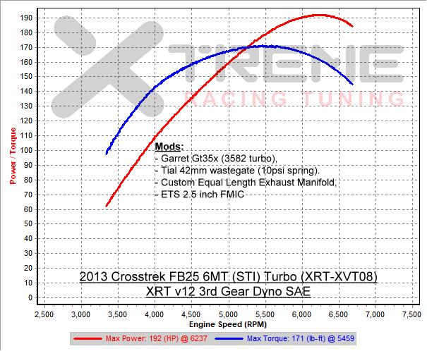

2013 Crosstrek FB25 6MT Turbo (XRT-XVT08)
2013 Subaru Crosstrek
2015 Subaru Outback FB25 intake AVCS, stock block housings, stock rods, stock pistons,
– ring gap
— #1 Ring .21mm
— #2 Ring .60mm
King Race Crank and Rod bearings,
Port matched FB25 heads, stock 2015 Subaru Outback cams.
2014 STI 6-speed manual, 2008 sti lsd rear differential
OS Giken pull-to-push conversion twin disk clutch
Altitude:
– 7000 ft (2133.6m)
– Estimated power at sea-level: 332whp
Turbo setup:
Garret Gt35x (3582 turbo)
Tial 42mm wastegate (10psi spring)
Custom Equal-Length exhaust manifold
ETS 2.5 inch FMIC, 2.75 inch intercooler piping
2013 Crosstrek throttle body
Fuel system:
Walbro 255 in-tank fuel pump,
Aeromotive Fuel Pressure Regulator
Stainless -6 AN-Lines
STI Injectors
Misc:
Catch can, pcv delete, billet aos valve,
2.5-inch core triple row half radiator.
No air conditioning.
NGK ilkar8h6 spark plugs, stock 2013 coil packs
