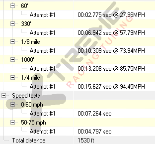

v2g Drag Times
Posted: Sat Jun 17, 2017 11:26 pm
v2g Drag Time #1.png (14.23 KiB) Viewed 19569 times
v2g Drag Time #2.png (13.96 KiB) Viewed 19569 times
