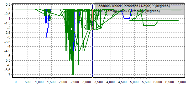

FL6T
Re: JohnnyW - 2008 USDM Subaru Legacy H6 3.0R 5EAT - Tuning
Post by FL6T »
Ed says pinging is horrible :roll:
