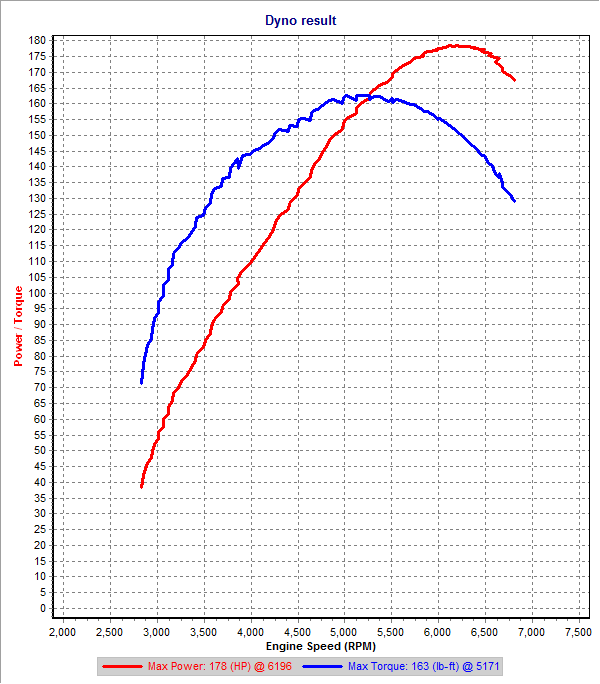

Stock Critical Data
Posted: Fri Mar 25, 2016 6:24 pm
Stock 2nd Gear Dyno SAE.png (21.77 KiB) Viewed 28155 times

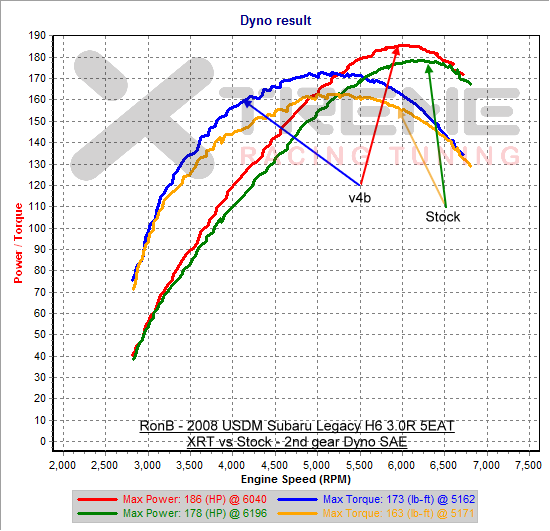

v4b 2nd Gear Dyno Results
Posted: Mon Jun 20, 2016 7:47 pm
v4b vs Stock - 2nd Gear Dyno.png (36.79 KiB) Viewed 28129 times
ROM V4B REVIEW
Posted: Tue Jun 21, 2016 5:21 pm
by RonH6
As the tuning continues, rom V4b did not dissappoint. The most noticeable change personally is the top end power compared to lower rom versions. The strip in which i do my pulls on, i find myself at the redline in 2nd quicker than before. The gears shift quick and smooth until i press the gas hard enough and the car starts to hold the gears in auto. The 5EAT is responding almost in regards to the way i want to drive off jump. Its impressive considering where we started. The throttle response is very sharp and i love it. Sometimes i do anticipate a harder pull when i floor it compared to lets say 65% throttle, but considering the N/A power linearity, it seems accurate. The fuel consumption has held pretty constant considering previous roms aswell. Idle is slightly lower then previous versions too.

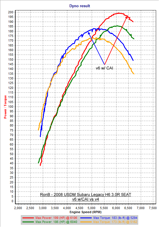

Posted: Sat Jun 25, 2016 11:03 pm
Weather - https://www.wunderground.com/cgi-bin/hi ... &width=614
v6 2nd Gear Dyno.png (32.74 KiB) Viewed 28084 times
ROM V6 REVIEW
Posted: Mon Jun 27, 2016 11:05 am
by RonH6
This update was an absolute charm! V6 with my CAI made my car actually break tires for a second @ 3700RPM~ pull!. The power delivery is near instant from when my foot is on the pedal. The torque hits the car hard and from 5000- to redline she pulls very hard. The 5EAT is trying to shift so fast that in auto, sometimes from 3rd it has to downshift back to second. The gears hold once i give it atleast 80% throttle. The fuel consumption got better even with me flooring it! ROM V6 works like a charm and compliments the CAI nicely! I love the highend POWAAA!!!

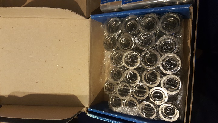

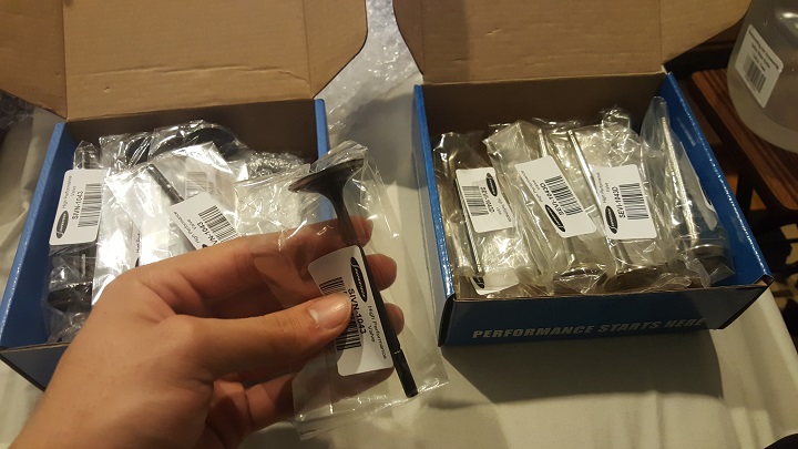

After: Ed noticed that my car didnt show any significant gains prior to headers upgrade. With that being said, he helped me with the hunt to find out why. Come to find out, my motor is not holding compression possibly due to previous lean conditions which caused my valves to warp due to heat which happened before tuning. So now I am currently in possession of supertech 1+MM valves and springs, subaru oem valve seal gasket kit, and new plugs (coolant is splashing on current plugs) to resolve my problem with an upcoming rebuild. I have decided that i might also due a port and polish because the head of the motor will be off. Even though this was a disappointing find, i am excited to see what new found power my leggy will bring. Ed was and IS a big help throughout the process and always is honest can be.
Below are some pictures of the header install, cold air intake cut and fab (current), and upcoming mods.
