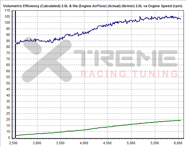

v0 Engine VE
v0 Engine VE
v0 Engine VE.png (18.42 KiB) Viewed 14417 times

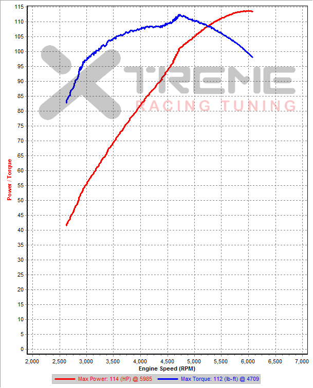

v0 2nd Gear Dyno SAE
v0 2nd Gear Dyno SAE.png (33.98 KiB) Viewed 14408 times

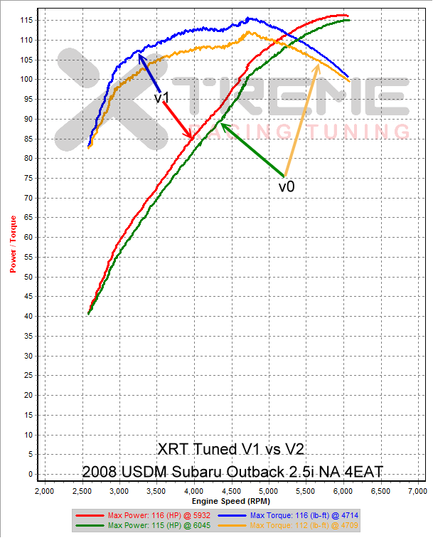

V1 Stats
Posted: Tue Oct 08, 2013 8:27 pm
From: papajam
Sent: Tuesday, October 08, 2013 7:36 PM
Subject: RE: Re: v1
All I can say for now is that the engine feels GREAT! The low end is FAR better than stock. And on about half throttle in 1st gear Sport mode, it felt like the engine came ‘on cam’ about 4000RPM. It simply took off!!  Mileage increased from yesterday’s 22.35 to 25.76
v1 2nd Gear Dyno SAE.png (43.04 KiB) Viewed 14395 times
