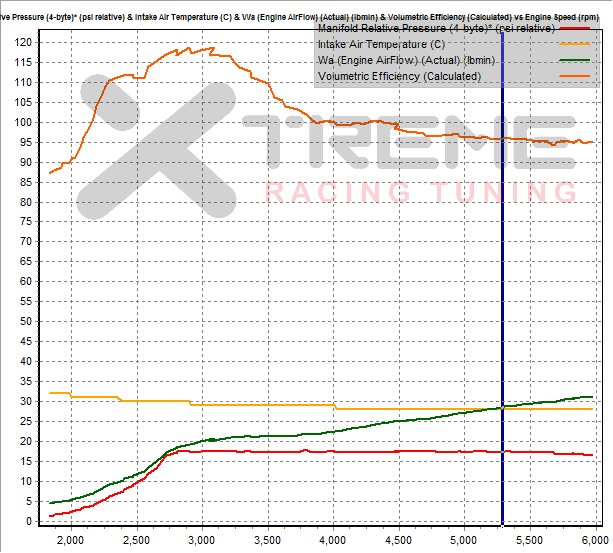

Engine VE in 3rd Gear.png (7.55 KiB) Viewed 28691 times

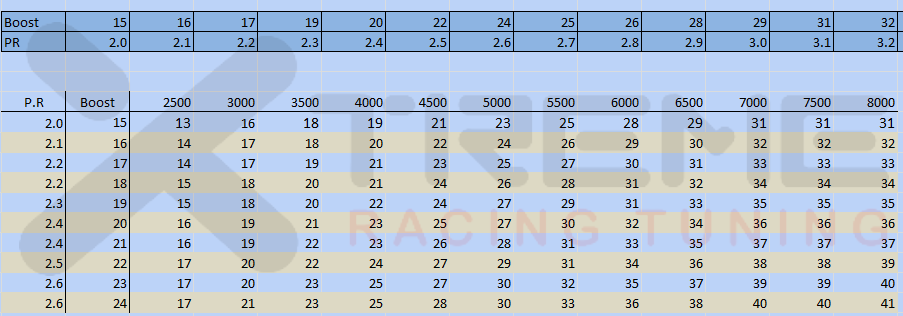

Engine Flow relative to Rel.boost.png (42.11 KiB) Viewed 28691 times

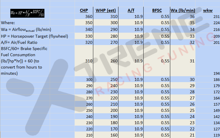

Engine Power relative to Engine Flow.png (60.1 KiB) Viewed 28691 times

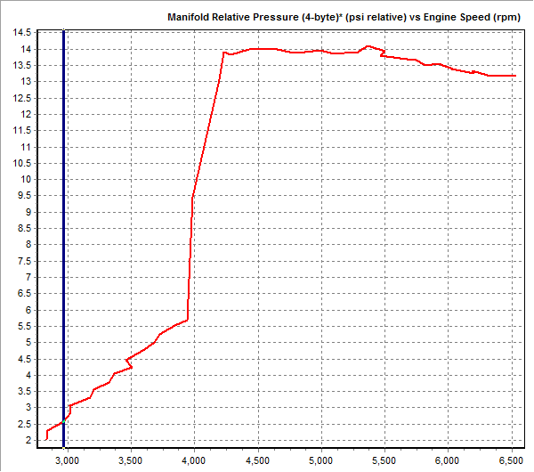

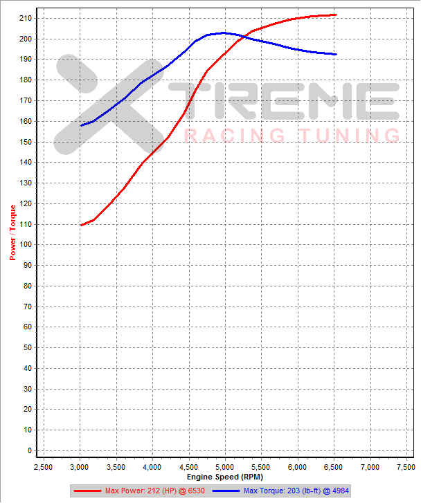

Stock Data
Posted: Sat May 25, 2013 6:15 pm
Boost curve.png (11.15 KiB) Viewed 28725 times

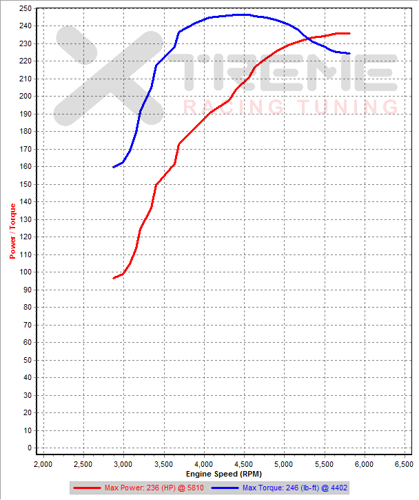

Stock 2nd Gear Dyno SAE #1 v2.png (26.04 KiB) Viewed 28725 times

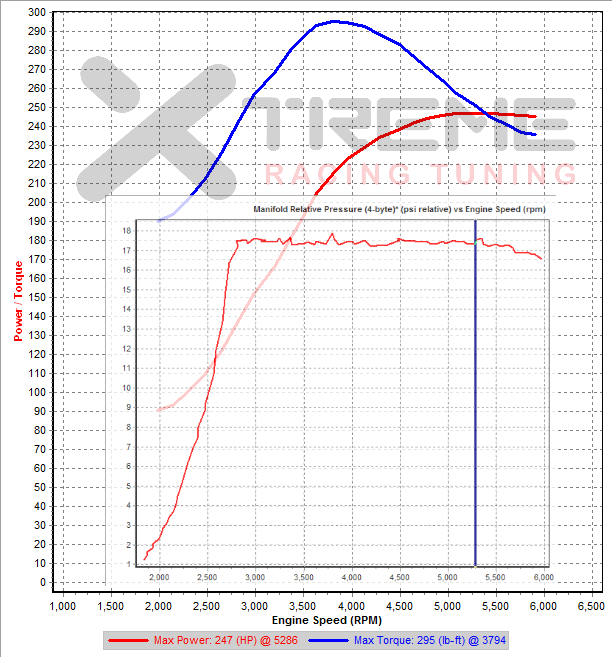

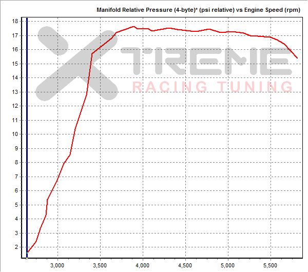

v5 Stats
Posted: Sun May 26, 2013 7:54 pm
v5 2nd Gear Dyno SAE Boost=17.5psi.png (17.07 KiB) Viewed 28721 times

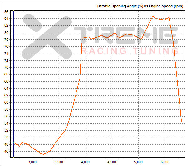

v5 2nd Gear Dyno SAE Throttle.png (18.74 KiB) Viewed 28721 times

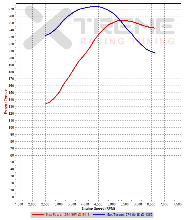

v5 2nd Gear Dyno SAE @ 17.5psi v2.png (23.82 KiB) Viewed 28691 times

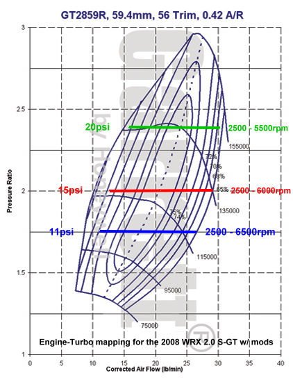

Turbo IHI VF47 Turbo seems to be equivalent to the Garret GT2859R
2008 Subaru WRX 2.0 S-GT Compressor Mapping
2008 Subaru WRX 2.0 S-GT Compressor Mapping.png (185.47 KiB) Viewed 28198 times

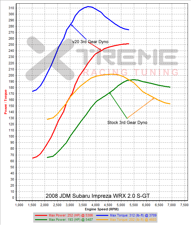

The car been retuned with a rev limit set to 5650 rpm. Boost been increased to 19.5-20psi to maximised the turbo sweet spot, tq and engine flow based on the driver needs. DBW changes been made to make the throttle run 100% at 30+% of accelerator. The torque is constantly around 300wftlb
v20 vs Stock - 3rd Gear Dyno SAE
Posted: Sun Jul 21, 2013 3:01 pm
v20 vs Stock - 3rd Gear Dyno SAE.png (41.8 KiB) Viewed 28538 times

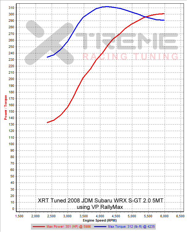

VP RallyMax @ 20psi
Posted: Sun Oct 20, 2013 6:51 pm
vprm6 3rd Gear Dyno SAE sm=2 tm=150.png (34.07 KiB) Viewed 28236 times
