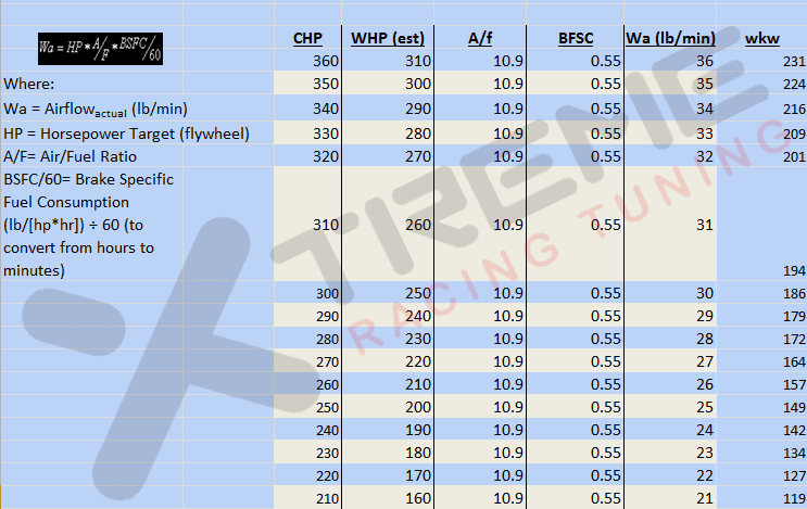

Engine Flow relative to Rel.boost.png (42.11 KiB) Viewed 28665 times
Engine Power relative to Engine Flow.png (60.1 KiB) Viewed 28665 times

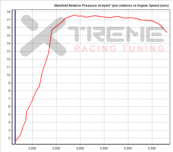

v5 Stats
v5 2nd Gear Dyno SAE Boost=17.5psi.png (17.07 KiB) Viewed 28695 times

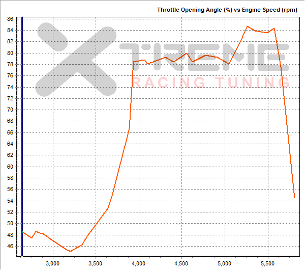

v5 2nd Gear Dyno SAE Throttle.png (18.74 KiB) Viewed 28695 times

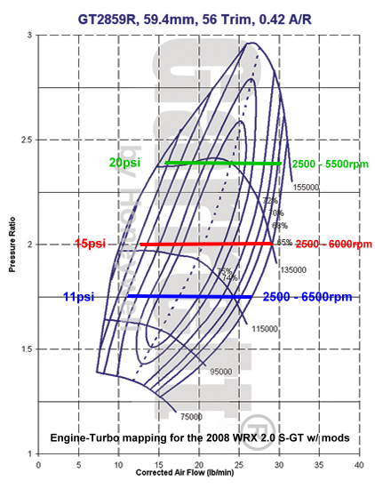

Re: RobertB - 2008 JDM Subaru Impreza 2.0 S-GT 5MT
Turbo IHI VF47 Turbo seems to be equivalent to the Garret GT2859R
2008 Subaru WRX 2.0 S-GT Compressor Mapping
2008 Subaru WRX 2.0 S-GT Compressor Mapping.png (185.47 KiB) Viewed 28172 times

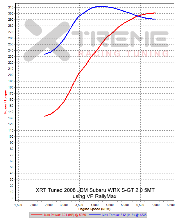

VP RallyMax @ 20psi
vprm6 3rd Gear Dyno SAE sm=2 tm=150.png (34.07 KiB) Viewed 28210 times
