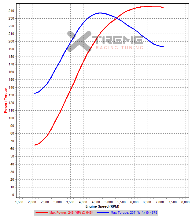

Stock 3rd Gear SAE sm=2 trim=150.png (20.13 KiB) Viewed 12063 times

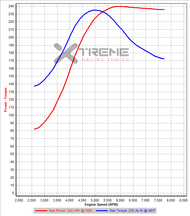

Stock 4th Gear SAE sm=2 trim=150.png (20.18 KiB) Viewed 12063 times

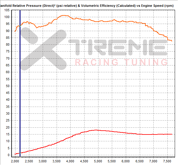

v1 3rd Gear Dyno SAE VE.png (20.95 KiB) Viewed 11852 times

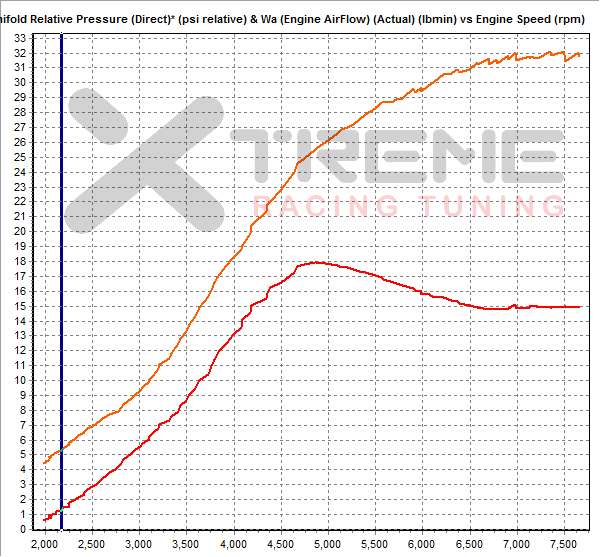

v1 3rd Gear Dyno SAE Engine Flow.png (21.98 KiB) Viewed 11852 times

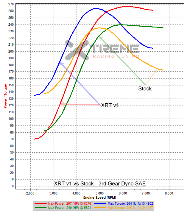

v1 vs Stock - 3rd Gear Dyno SAE.png (48.17 KiB) Viewed 12058 times

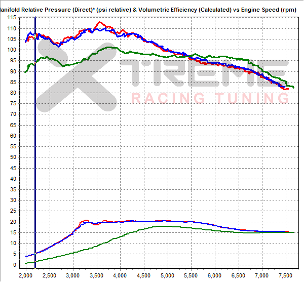

With exhaust mods and different gear used, the graph shows existing boost leaks. The Turbo inter-cooler have crack leaking air at running boost.
VE showing boost leaks.png (23.55 KiB) Viewed 11852 times
