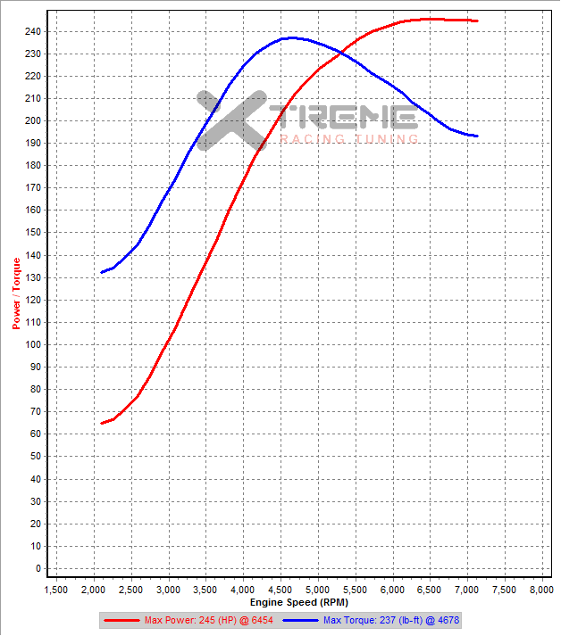

Stock 3rd Gear SAE sm=2 trim=150.png (20.13 KiB) Viewed 12050 times
Stock 4th Gear SAE sm=2 trim=150.png (20.18 KiB) Viewed 12050 times

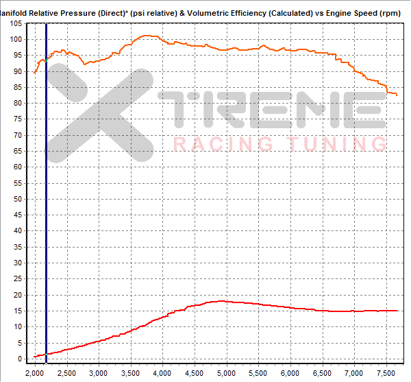

v1 3rd Gear Dyno SAE VE.png (20.95 KiB) Viewed 11839 times

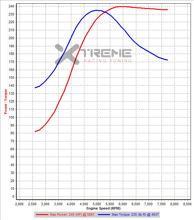

v1 3rd Gear Dyno SAE Engine Flow.png (21.98 KiB) Viewed 11839 times
v1 vs Stock - 3rd Gear Dyno SAE.png (48.17 KiB) Viewed 12045 times
Re: DSmith - XRT JDM Subaru WRX STI-05
With exhaust mods and different gear used, the graph shows existing boost leaks. The Turbo inter-cooler have crack leaking air at running boost.
VE showing boost leaks.png (23.55 KiB) Viewed 11839 times
