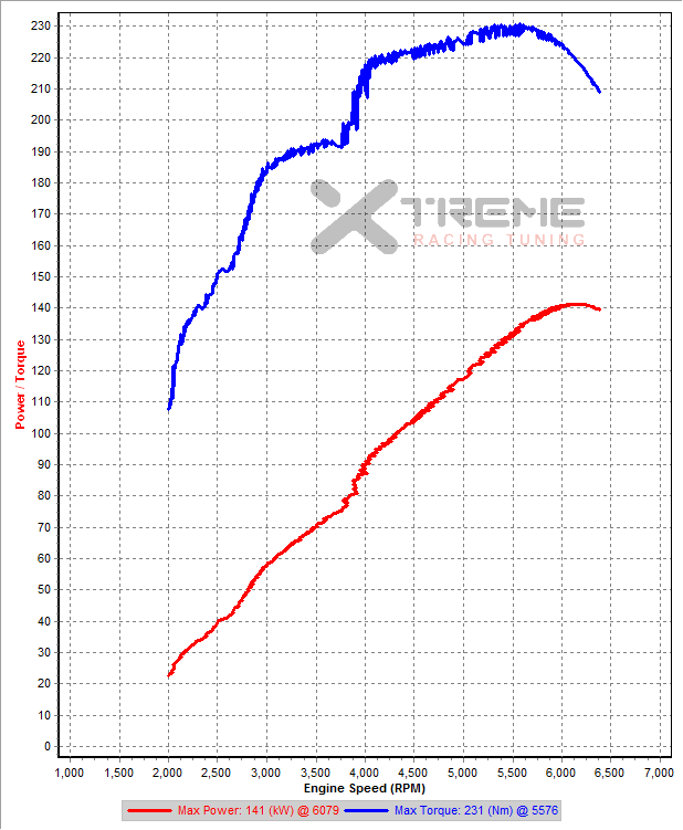

All dyno'es are based on Speed
Stock 3rd Gear Dyno SAE
Posted: Thu Sep 27, 2012 7:53 pm
Stock 3rd Gear Dyno SAE.png (21.08 KiB) Viewed 27426 times

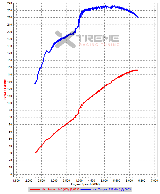

v2 Dyno
Posted: Fri Sep 28, 2012 11:37 pm
v2 3rd Gear Dyno SAE.png (23.32 KiB) Viewed 27442 times

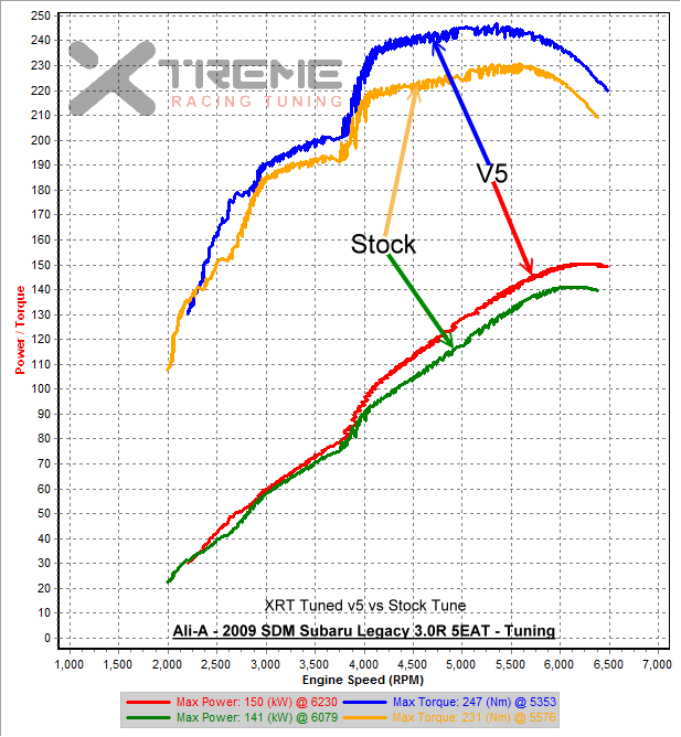

v5 3rd Gear Dyno
Posted: Fri Oct 19, 2012 3:14 pm
3rd Gear Dyno SAE - XRT Tuned v5 vs Stock Tune.png (40.52 KiB) Viewed 27038 times

150kw/247Nm (Weight reduced by around 100kg, otherwise it could jump higher, I care about acceleration)
