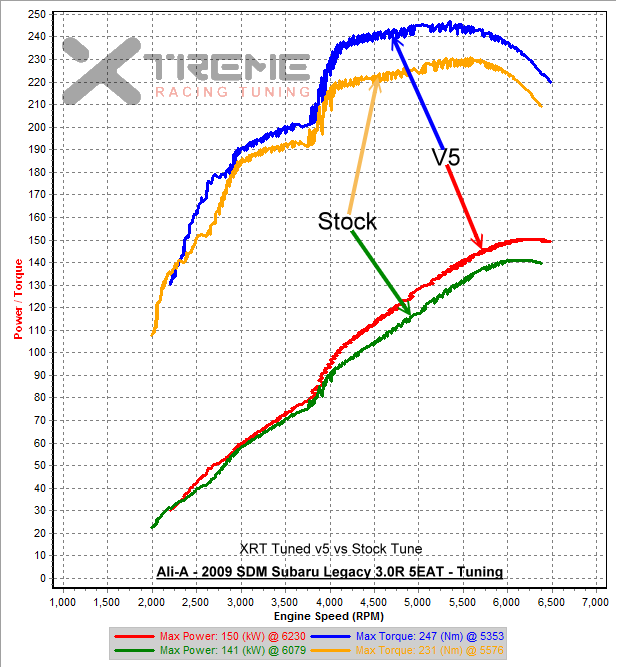

All dyno'es are based on Speed
Stock 3rd Gear Dyno SAE
Stock 3rd Gear Dyno SAE.png (21.08 KiB) Viewed 27468 times
v2 Dyno
v2 3rd Gear Dyno SAE.png (23.32 KiB) Viewed 27484 times
v5 3rd Gear Dyno
3rd Gear Dyno SAE - XRT Tuned v5 vs Stock Tune.png (40.52 KiB) Viewed 27080 times

150kw/247Nm (Weight reduced by around 100kg, otherwise it could jump higher, I care about acceleration)
Ed,
I'm very satisfied with the car's performance so far and I'm sure it will become much more better when it learns.
Couple of interesting things:
- The car now jumps when launching, great response!
- Torque is great, you feel the power in the pedal!
- Learning!! whatever your driving style is, the car learns it fast.
- Shifting in the 3gear became a lot faster.
- Power starts in around 2500rpm, thanks to Raptor headers.
- More fuel usage.
- FUN, the great response makes it more sporty.
