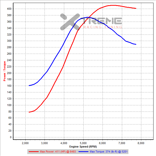

2006 JDM STI Spec C engine swapped into a 2004 JDM STI Spec C
  • FMIC
  • ID1000 Injectors
  • Subaru WRX/STi Dominator 1.5XT-R Twinscroll Turbocharger
  • Blitz Boost Controller
  • Perrin Intake
  • Full HKS Turbo-back 3" Exhaust system
Target AFR = 11.98
IAT = 68C to 50C
Inj Max. Duty = approx. 60%
Dynoes performed and varying roads, which affect results.
Dyno Correction Factor: Buschur Racing Mustang = 0.917
3rd Gear Dyno SAE 15PSI
GpN v15 3rd Gear Dyno SAE 15PSI.png (20.34 KiB) Viewed 36997 times

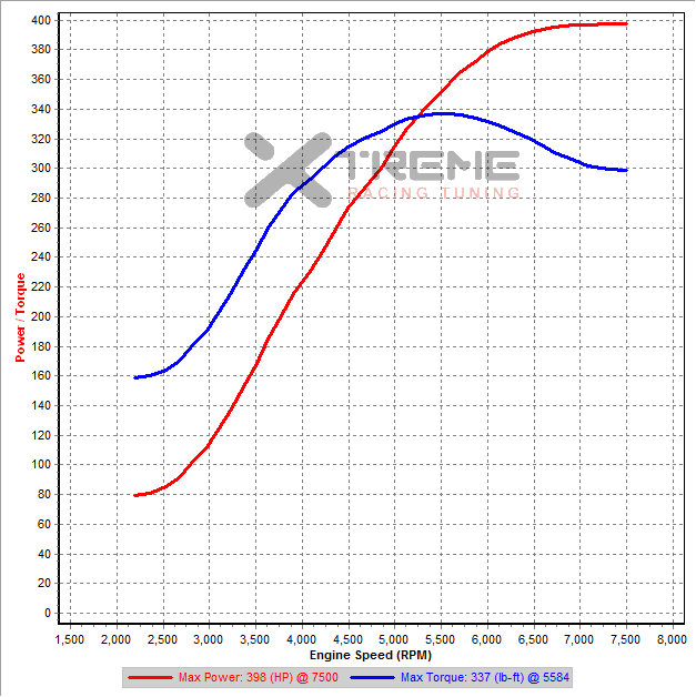

3rd Gear Dyno SAE 18PSI
GpN v9 3rd Gear Dyno SAE 18PSI.png (19.08 KiB) Viewed 37000 times
