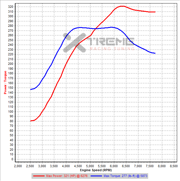

3rd Gear Dyno SAE 15PSI
GpN v15 3rd Gear Dyno SAE 15PSI.png (20.34 KiB) Viewed 36977 times

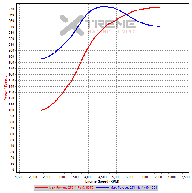

3rd Gear Dyno SAE 18PSI
GpN v9 3rd Gear Dyno SAE 18PSI.png (19.08 KiB) Viewed 36980 times

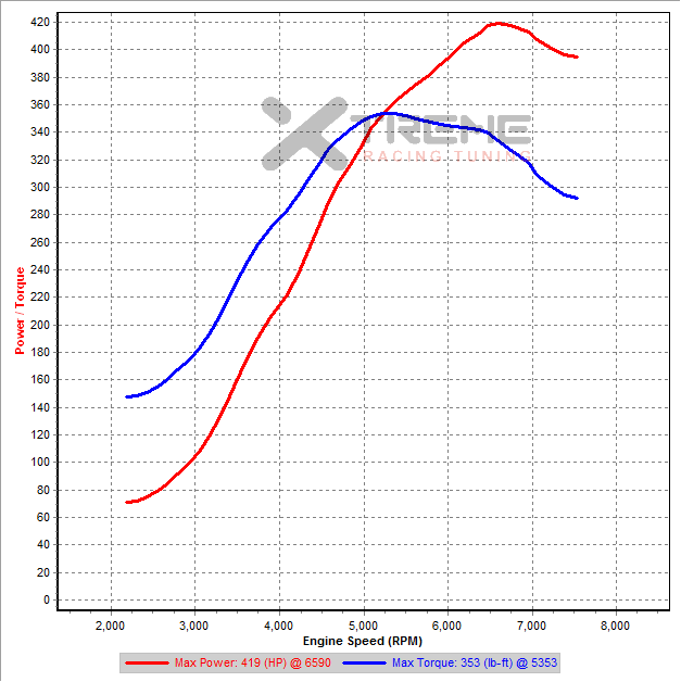

3rd Gear Dyno SAE 25PSI
v16 3rd Gear Dyno SAE 25PSI #1.png (23.1 KiB) Viewed 36953 times

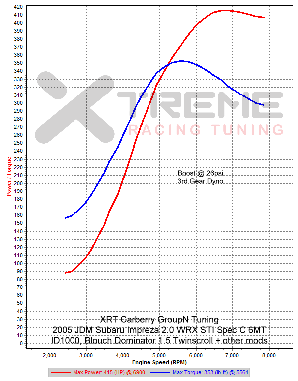

3rd Gear Dyno SAE 26PSI
3rd Gear Dyno SAE 26PSI.png (19.25 KiB) Viewed 36984 times

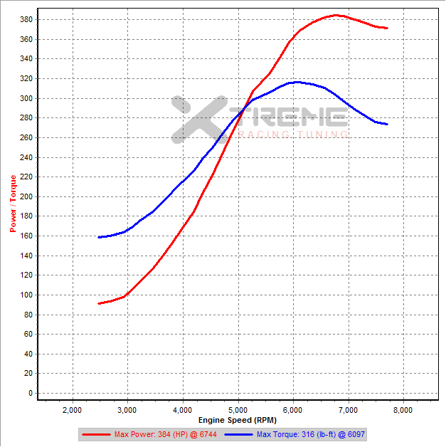

4th Gear Dyno SAE 21.5PSI
GpN v13 4th Gear Dyno SAE 21.5PSI.png (19.29 KiB) Viewed 36983 times
