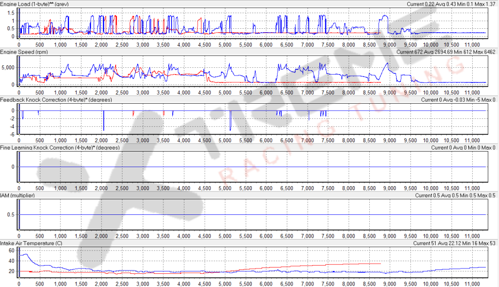

Stock Criticals
Posted: Sat Jul 07, 2012 9:05 pm
Stock Criticals.png (267.62 KiB) Viewed 55004 times

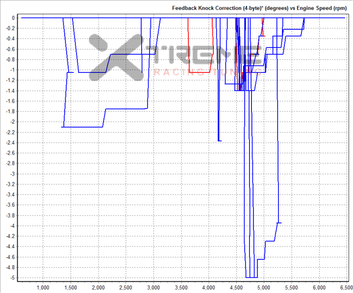

Stock Criticals - FBKC.png (122.99 KiB) Viewed 55004 times

Avg IAT = 18C
Stock Criticals - EL.png (140.94 KiB) Viewed 55004 times

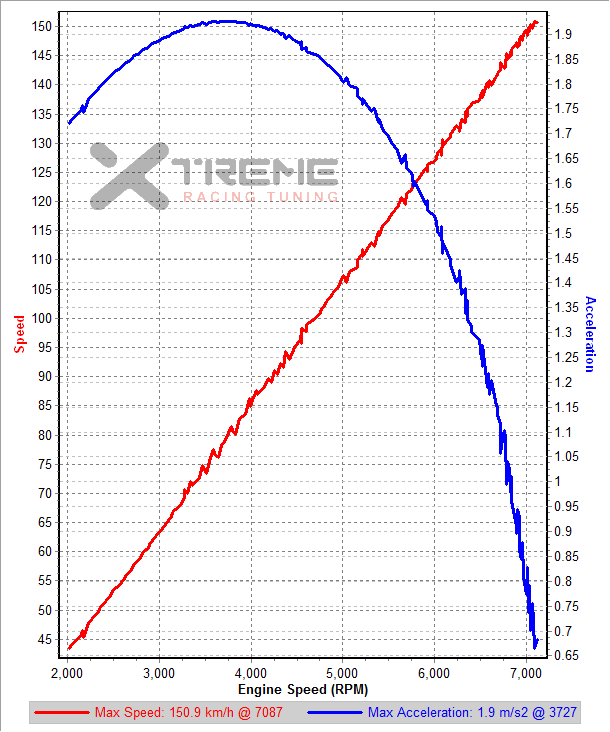

stock 3rd Gear Dyno SAE.png (22.89 KiB) Viewed 54991 times
Stock 3rd Gear Acceleration.png (27.52 KiB) Viewed 54980 times

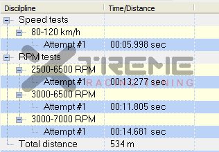

Stock 3rd Gear Times.png (5.64 KiB) Viewed 54980 times

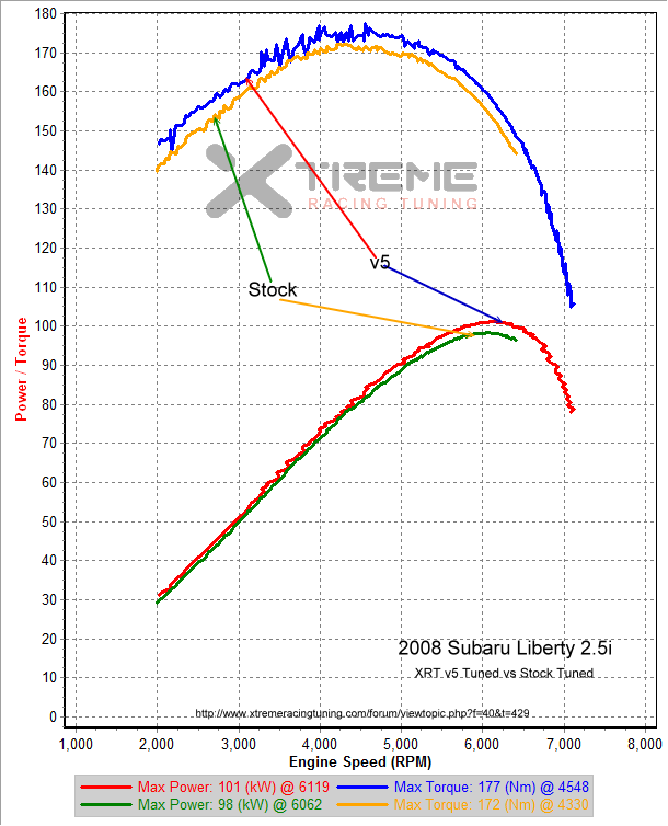

Customer Response to v5
Posted: Thu Jul 12, 2012 9:40 pm
XRT v5 Tuned vs Stock.png (41.43 KiB) Viewed 54986 times
Bumpy curve is due to running on the road shoulder
Please find attached the 3rd gear pulls and driving logs for v5. I couldn't feel too much difference between v4 and v5 except in the high rpm range. Through the low to mid range I didn't notice anything but up in the higher rpm, expecially when I was just driving how I normally do, I noticed that the revs just felt like they were climbing faster. When I got to around 5000rpm I noticed it just felt quicker to get up to 6500 and it really feels agressive when I jump on the power. The whole car wobbles going on and off the power...time for suspension upgrade lol.
V5 3rd Gear Times.png (8.23 KiB) Viewed 54980 times
