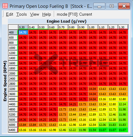

Stock Fuel Map.png (22.74 KiB) Viewed 54943 times

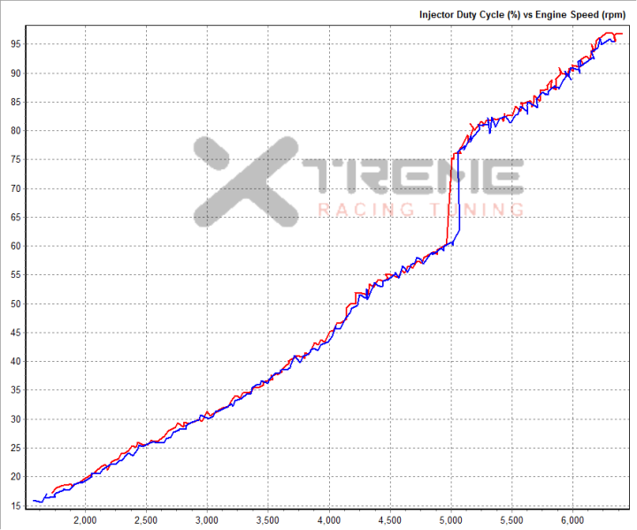

Stock Criticals - Inj.png (96.38 KiB) Viewed 54945 times
Sudden increase in Inj duty cycle due to fuel map.

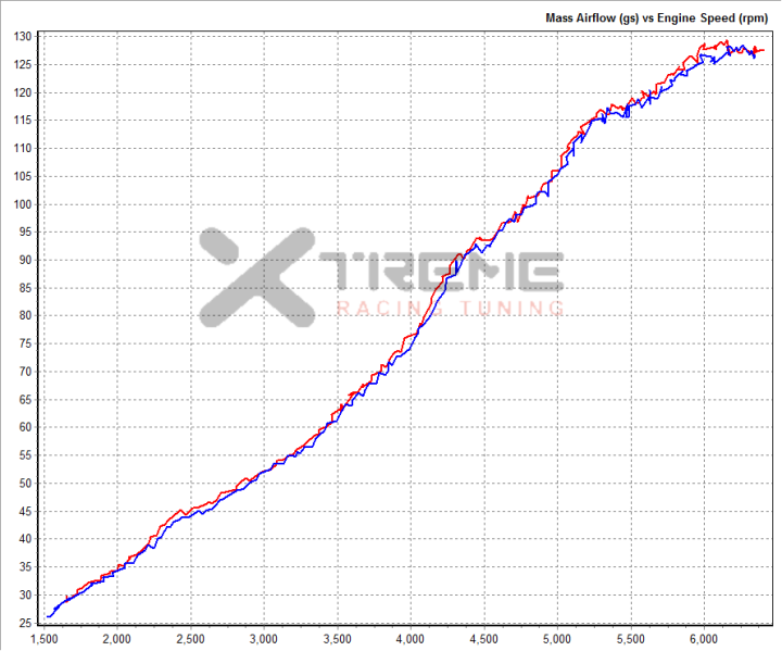

Stock Criticals - Mass Airflow.png (109.27 KiB) Viewed 54945 times

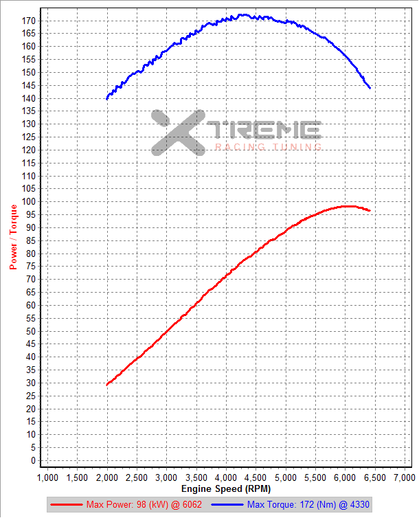

stock 3rd Gear Dyno SAE.png (22.89 KiB) Viewed 54932 times
