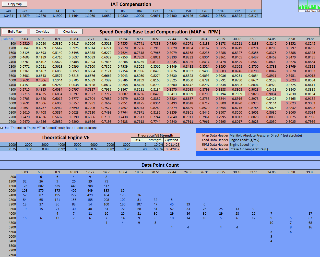

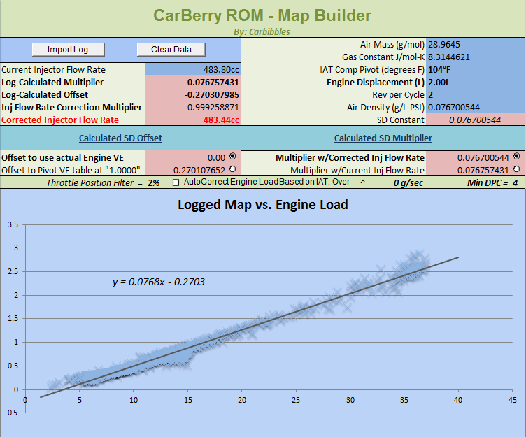

RyanF - XRT Subaru STI-03 w/ XRT-GpN Variant ROM w/ LC+AL
Posted: Sun Mar 18, 2012 9:24 pm
Video - http://www.youtube.com/watch?v=wbaoaG3OyWs
2004 JDM WRX w/ 2005 STi Engine
  • FP 68HTA Turbo
  • Perrin EL Header & Wrap
  • HKS HI-Power Turboback. DP wrap
  • AEM Meth/Water Injection. 50/50
  • AEM CAI
  • Sparco Big TMIC
  • Boost setup: Controller between the WG and Compressor
  • Elevation: Close to sea level
SD Mapping 1.png (106.64 KiB) Viewed 19282 times
SD Mapping 1_1.png (76.85 KiB) Viewed 19282 times

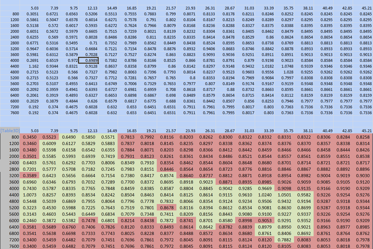

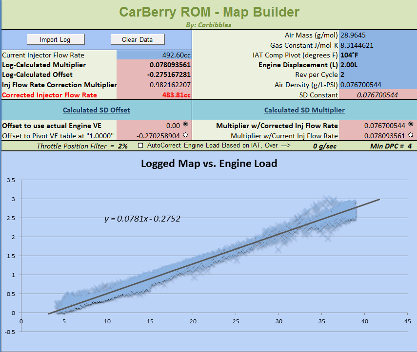

Re: XRT Subaru STI-03 w/ XRT-GpN Variant ROM w/ LC + AL
Posted: Wed Mar 21, 2012 9:12 pm
v16 SD.png (79.49 KiB) Viewed 19278 times
v16 SD-diff.png (54.83 KiB) Viewed 19278 times
sd log mapping.png (73.85 KiB) Viewed 19278 times

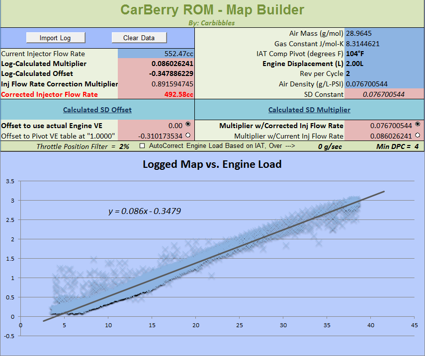

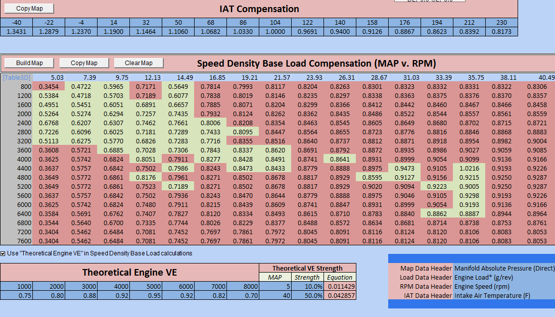

SD config from SD Engine Load
Posted: Thu Mar 29, 2012 11:43 pm
SD Calc from SD Eng Load.png (92.41 KiB) Viewed 19266 times
SD Calc from SD Eng Load - mapping.png (110.73 KiB) Viewed 19266 times

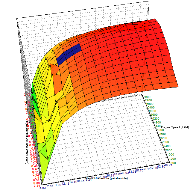

v17 SD MAP
Posted: Mon Apr 02, 2012 7:18 pm
v17-SD Map.png (79.06 KiB) Viewed 19259 times
v17-SD Map-main.png (57 KiB) Viewed 19259 times

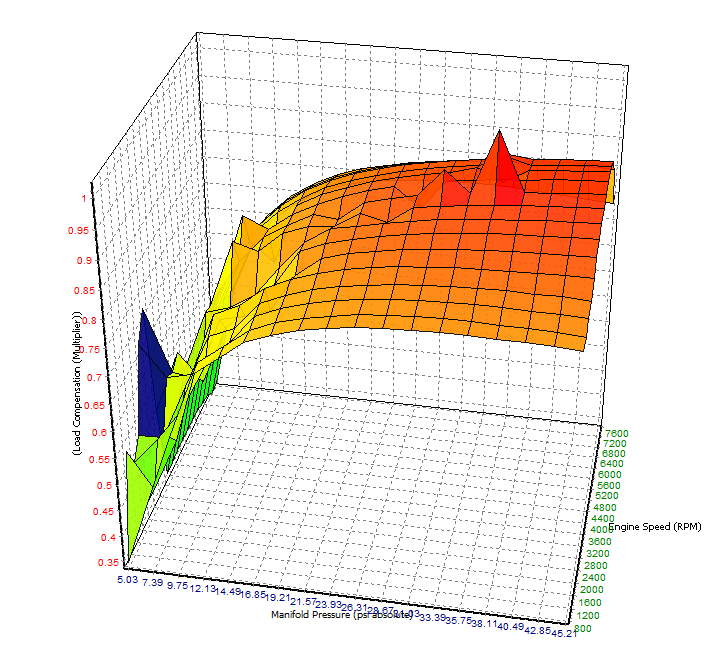

v17 vs v18 SD 3D Map
Posted: Mon Apr 02, 2012 8:31 pm
v17 SD.png (52.49 KiB) Viewed 19259 times
v18 SD.png (47.5 KiB) Viewed 19259 times

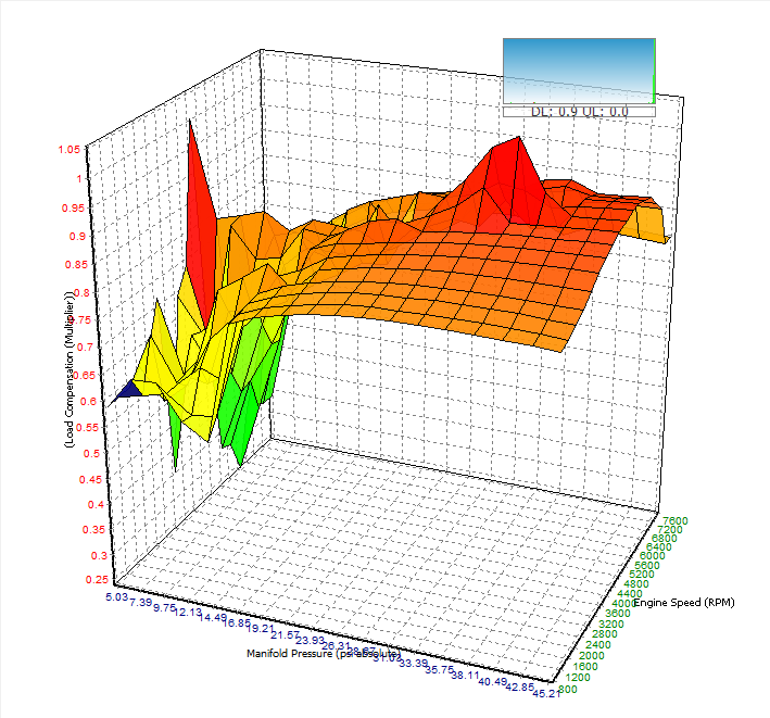

v19 SD: To be tested
Posted: Mon Apr 02, 2012 8:55 pm
Still a lot of work for idling and cruising
v19 SD.png (53.56 KiB) Viewed 19259 times

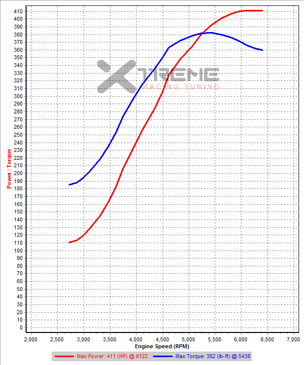

v18 3rd Gear Dyno
Posted: Fri Jun 01, 2012 12:34 am
Posted: Fri Mar 29, 2013 6:40 pm
sti-v28g-coolant 3rd Gear Dyno SAE.png (22.37 KiB) Viewed 18425 times
