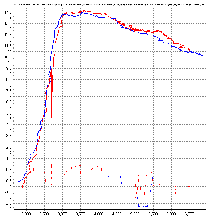

Stock Boost Curve with Pinging.png (20.96 KiB) Viewed 12032 times
2nd Gear boost (IAT=22C) vs 3rd Gear boost (IAT=33C)
The red line is 3rd Gear boost curve

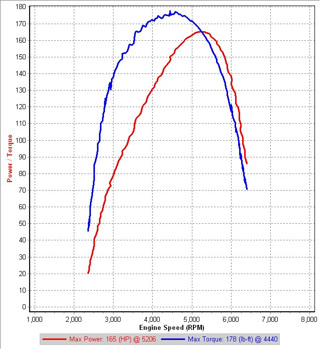

Stock 2nd Gear Dyno IAT=28-27C.png (14.17 KiB) Viewed 12029 times

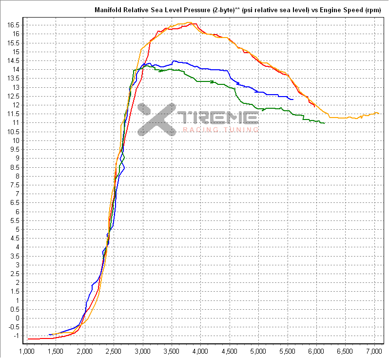

v4 vs Stock 2nd Gear Boost.png (25.32 KiB) Viewed 12029 times
Red&Orange is Stage 1 XRT boost vs stock boost Green&blue

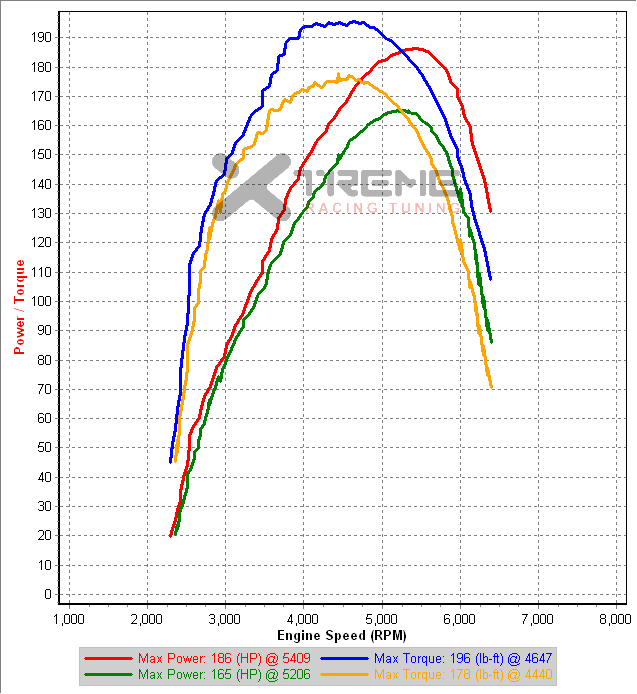

v4 vs Stock 2nd Gear Dyno.png (21.78 KiB) Viewed 12029 times
v4 are the Red and Blue lines

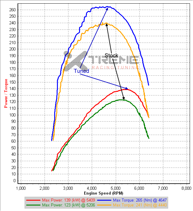

v4 vs Stock 2nd Gear Dyno kw.png (30.04 KiB) Viewed 12027 times
