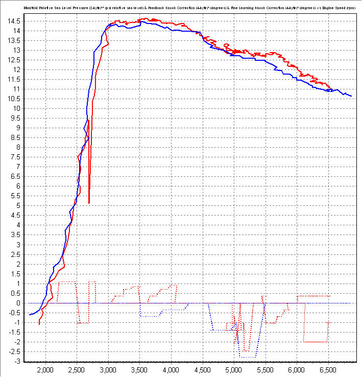

Stock Critical Stats.png (29.72 KiB) Viewed 12001 times
Stock Boost Curve with Pinging.png (20.96 KiB) Viewed 12001 times

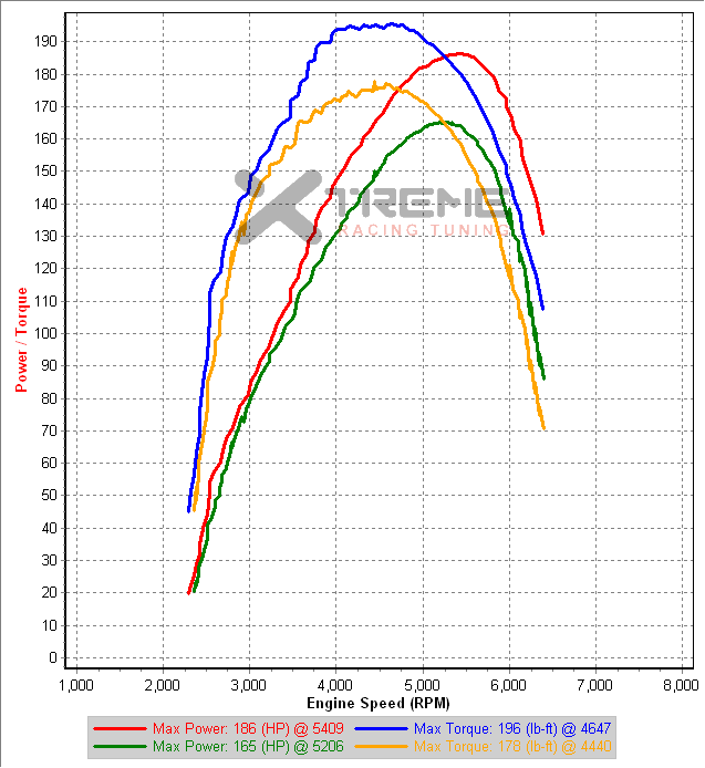

2nd Gear boost (IAT=22C) vs 3rd Gear boost (IAT=33C)
The red line is 3rd Gear boost curve
Stock 2nd Gear Dyno IAT=28-27C.png (14.17 KiB) Viewed 11998 times

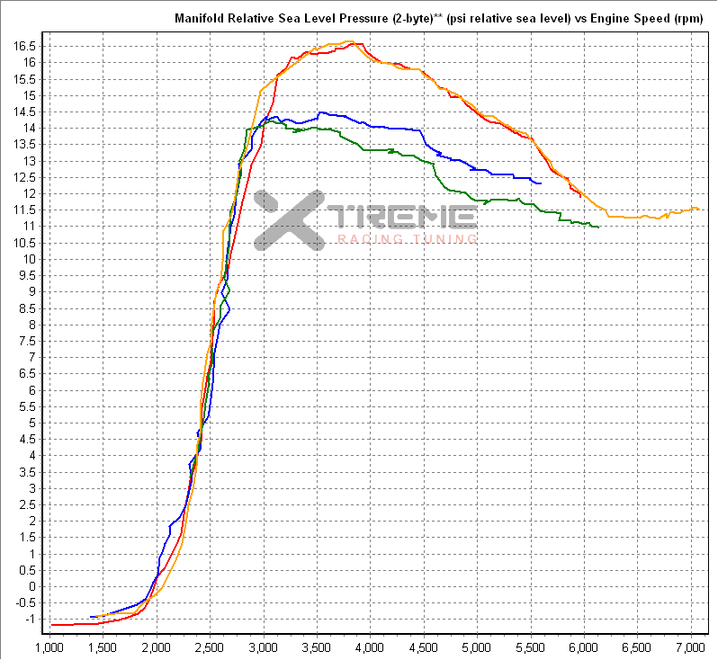

v4 Stats
v4 vs Stock 2nd Gear Boost.png (25.32 KiB) Viewed 11998 times
Red&Orange is Stage 1 XRT boost vs stock boost Green&blue

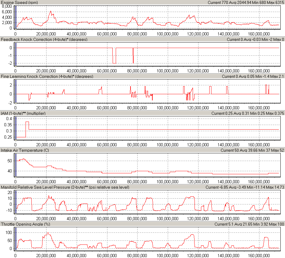

v4 vs Stock 2nd Gear Dyno.png (21.78 KiB) Viewed 11998 times
v4 are the Red and Blue lines

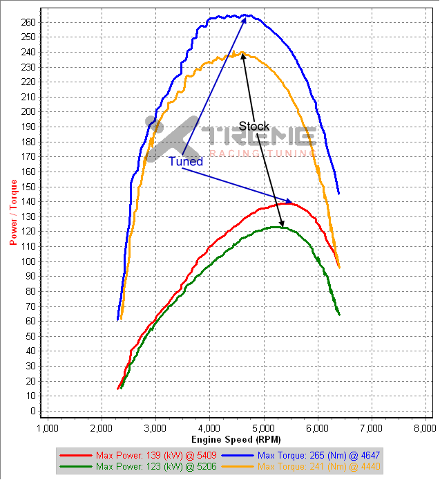

v4 vs Stock 2nd Gear Dyno kw.png (30.04 KiB) Viewed 11996 times
