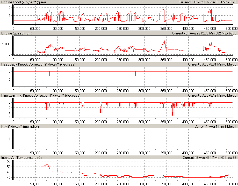

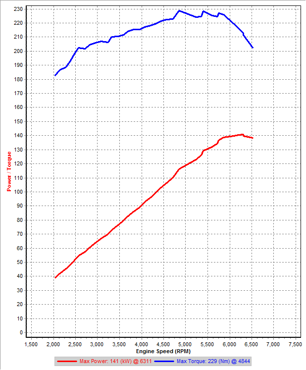

v1 Stats
Posted: Sun Dec 11, 2011 2:20 pm

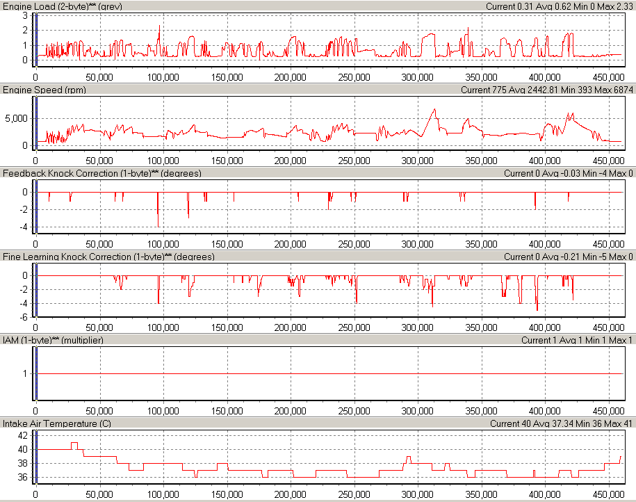

Full tank of Gas. Doesn't seem the same quality. IAM is now at 1. So all the ign Adv. is being added now.
V1 Engines Stats.png (25.94 KiB) Viewed 12496 times

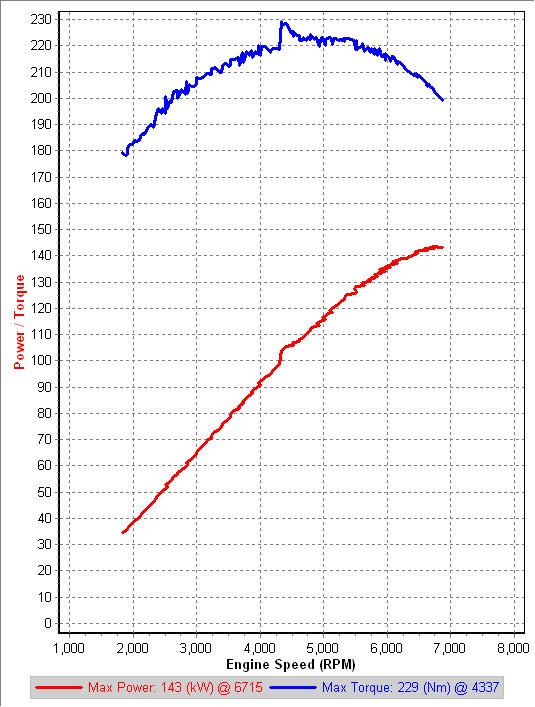

v1 3rd Gear Dyno SAE.png (16.11 KiB) Viewed 12054 times

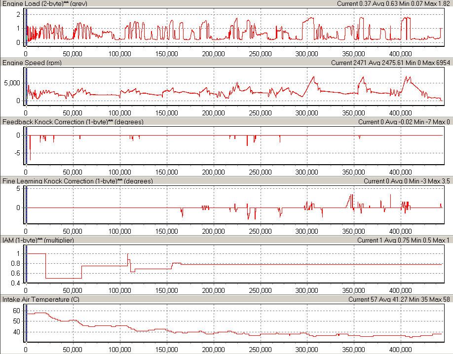

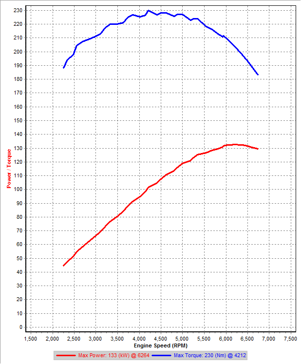

v2 Stats
Posted: Sun Dec 11, 2011 2:25 pm
V2 Engines Stats.png (23.91 KiB) Viewed 12496 times
When the dyno was performed, I am not sure if the customer brake. The rpm and speed at the point stop climbing.
v2 3rd Gear Dyno IAT=44-41C.png (14.03 KiB) Viewed 12496 times

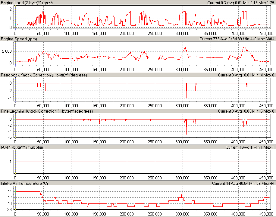

v3 Stats
Posted: Sun Dec 11, 2011 2:46 pm
Ok. Logs getting slowly clean.
V3 Engines Stats.png (24.63 KiB) Viewed 12496 times

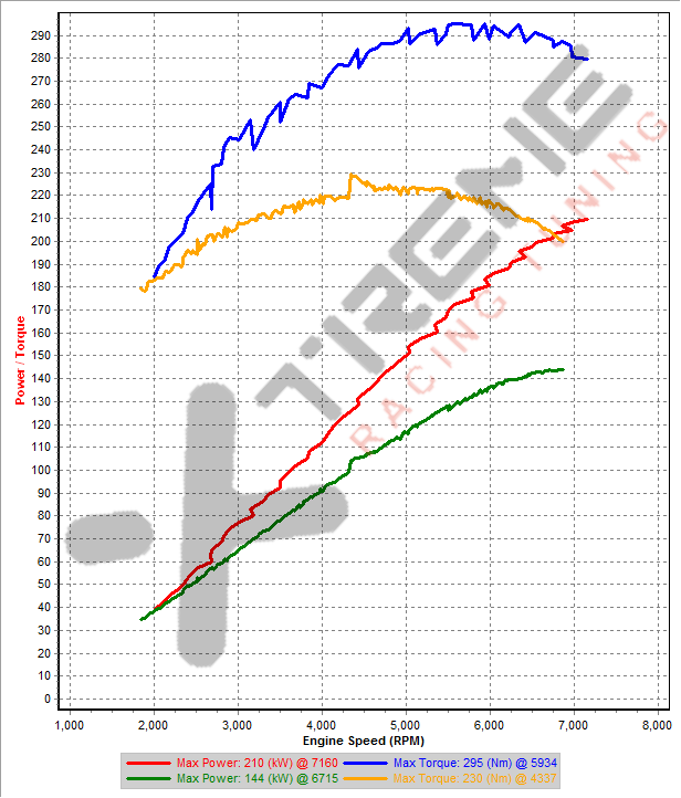

Scv9 vs NA-v2 3rd Gear Dyno SAE
Posted: Sat Oct 27, 2012 9:52 pm
A better cooler to be install + minor exhaust leaks to be rectified
scv9 vs NA-v2 - 3rd Gear Dyno SAE.png (58.49 KiB) Viewed 12021 times
Boost @ 5+psi
