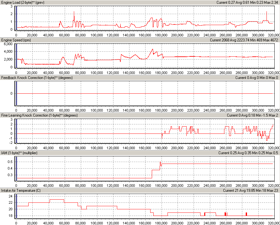

Stock Stats
Posted: Wed Nov 23, 2011 7:26 am
Stock Criticals.png (22.78 KiB) Viewed 9607 times

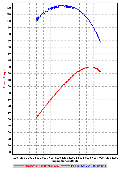

v1
Posted: Fri Nov 25, 2011 7:18 am
v1 3rd Gear Dyno IAT=19-18C.png (12.66 KiB) Viewed 9598 times

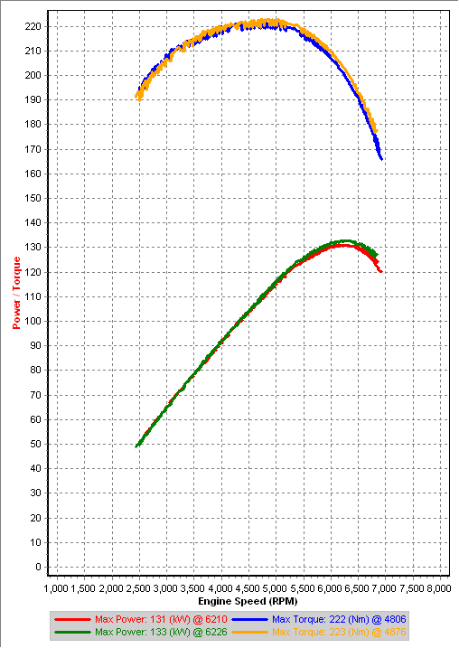

v1 4th Gear Dynos IAT=19-17C.png (13.94 KiB) Viewed 9598 times

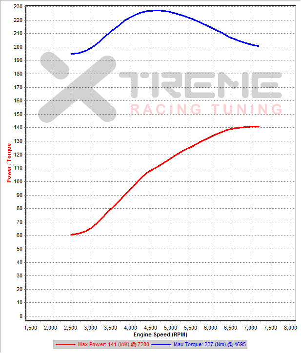

v3 Stats
Posted: Thu Nov 28, 2013 11:55 pm
v3 3rd Gear Dyno SAE sm=2 tm=150.png (22.07 KiB) Viewed 9049 times

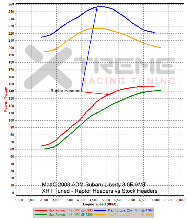

v7 Stats
Posted: Fri Nov 29, 2013 12:07 am
Loboka Hi flow cats
3rd Cat delete
X-force center and y pipe
Ganador straight through mufflers
Raptors Headers vs Stock Headers
v7 3rd Gear Dyno SAE sm=2 tm=150.xml.png (42.17 KiB) Viewed 9049 times
