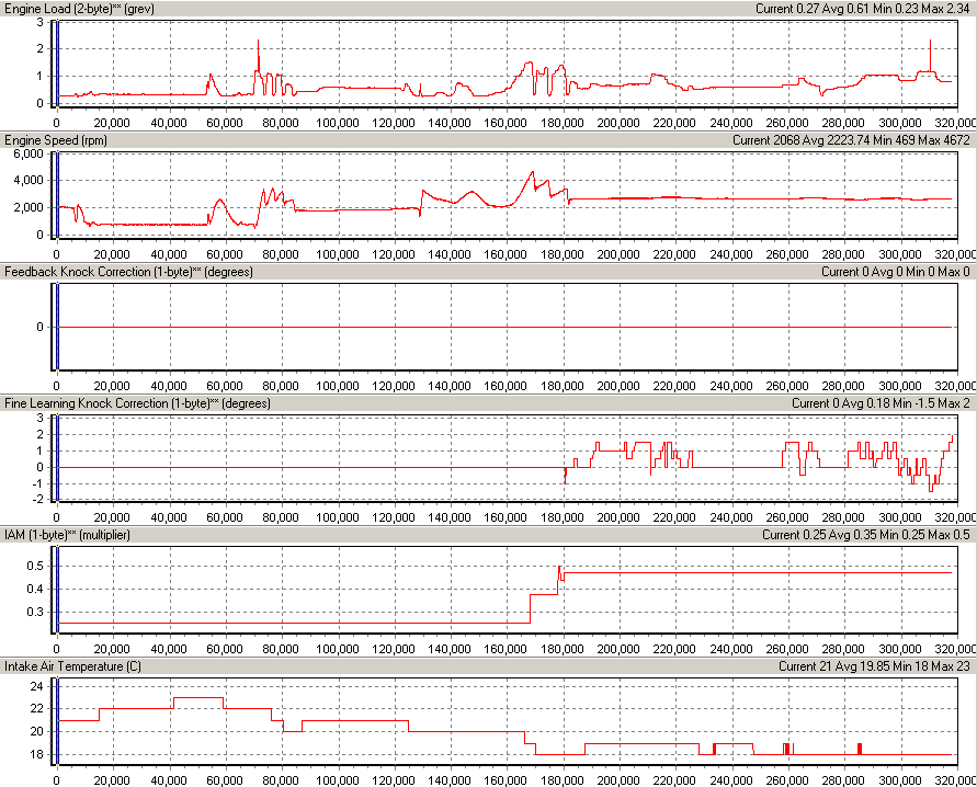

Stock Stats
Stock Criticals.png (22.78 KiB) Viewed 9613 times

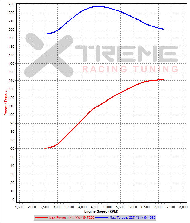

v3 Stats
v3 3rd Gear Dyno SAE sm=2 tm=150.png (22.07 KiB) Viewed 9055 times

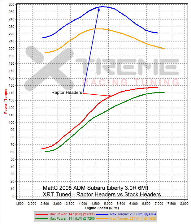

Raptors Headers vs Stock Headers
v7 3rd Gear Dyno SAE sm=2 tm=150.xml.png (42.17 KiB) Viewed 9055 times
