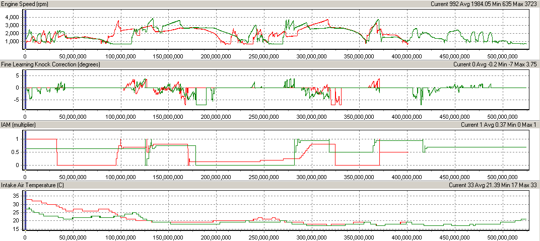

Posted: Wed Nov 02, 2011 6:28 am
v0 Stats.png (19.86 KiB) Viewed 21115 times
Based on v0 logs, slowly tuning out pinging.

Thanks Edward,
Can you explain the legend please, i.e. what does the green line represent and the same for the red line?
Regards
Paul

PaulB wrote:Thanks Edward,
Regards
Paul
There are two logs combined. The more the logs, the more the coloured lines.
All lines are self explanatory.
Explanation:- http://www.romraider.com/forum/topic4271.html
IAM: Varies how much ignition is added to the car based on how much pinging is detected. No pinging at all, the IAM=1. Pinging is happens due to Fuel quality, and poor engine maintenance. The Older the Oil, the more pinging you will have. Also please keep your fuel level close to full. Subarus are know to ping the lower the fuel level is.
FLKC: Show the ecu added and remove ign by degrees that was learnt.

Thanks, from that I assume that the shorter (red) line represents the first log of v0 and the green line the second log as that is the larger file?
As I travel the same road every time I find it interesting to map the log the the piece of road I was on. I also want to see if I can pin point the area in the log where it needed lots of persuasion (lots of throttle) to gear down.
Re: PaulB - 2008 African Subaru Tribeca B9 3.0R 5EAT - Tunin
Posted: Wed Nov 02, 2011 7:08 am
A replay of the log shows it. You will not be able to see it from these graphs. 1st and last log.
I posted it to show you the pinging and the stability of the IAM. V1 should be a lot stable.
