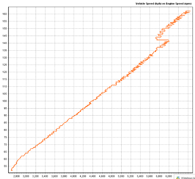

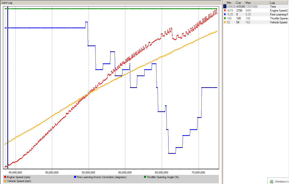

Below shows you the tranny locking up @ 6000rpm. This is what it looks like for your education

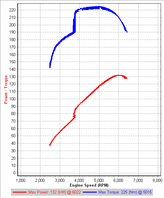

Stock 3rd Gear Dyno IAT=37-33C.png (12.99 KiB) Viewed 20903 times

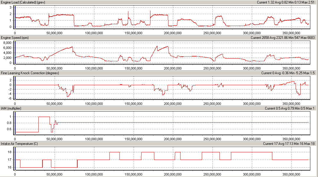

Based on v0 logs, slowly tuning out pinging.

There are two logs combined. The more the logs, the more the coloured lines.
All lines are self explanatory.
Explanation:- http://www.romraider.com/forum/topic4271.html
IAM: Varies how much ignition is added to the car based on how much pinging is detected. No pinging at all, the IAM=1. Pinging is happens due to Fuel quality, and poor engine maintenance. The Older the Oil, the more pinging you will have. Also please keep your fuel level close to full. Subarus are know to ping the lower the fuel level is.
FLKC: Show the ecu added and remove ign by degrees that was learnt.

I posted it to show you the pinging and the stability of the IAM. V1 should be a lot stable.

On the first log, the very first time I went to 6,000 rpm you see a dip just after 6,000rpm? What do you think that is? That is why I thought it shifted but can you confirm that my foot was still planted, i.e. and that I lifted off only after it had changed to 4th gear?
Thanks
Paul
PaulB
Re: PaulB - 2008 African Subaru Tribeca B9 3.0R 5EAT - Tunin
Post by PaulB »
Just to confirm that changing from 3rd to 4th gear from about 6000rpm should have at least a 1500 drop in rpm. I had a look yesterday. So what must have happened there at 6000rpm could only have been the torque converter. It was quite rough tough and felt more like a gear change than the converter locking up.
