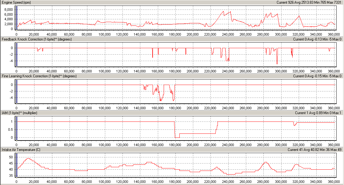

Stock Stats
Posted: Sun Oct 16, 2011 12:08 am
Stock stats.png (19.81 KiB) Viewed 12024 times

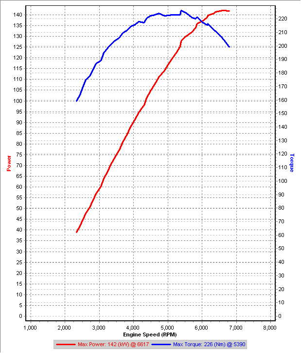

Stock 3rd Gear Dyno IAT=40C.png (16.74 KiB) Viewed 12024 times

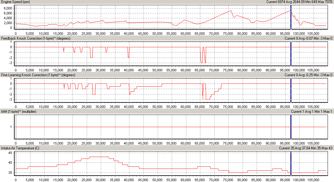

v0a Stats
Posted: Sun Oct 16, 2011 12:09 am
v0a Stats.png (23.17 KiB) Viewed 12024 times

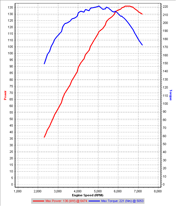

v0a 3rd Gear Dyno IAT=46C.png (16.38 KiB) Viewed 12024 times

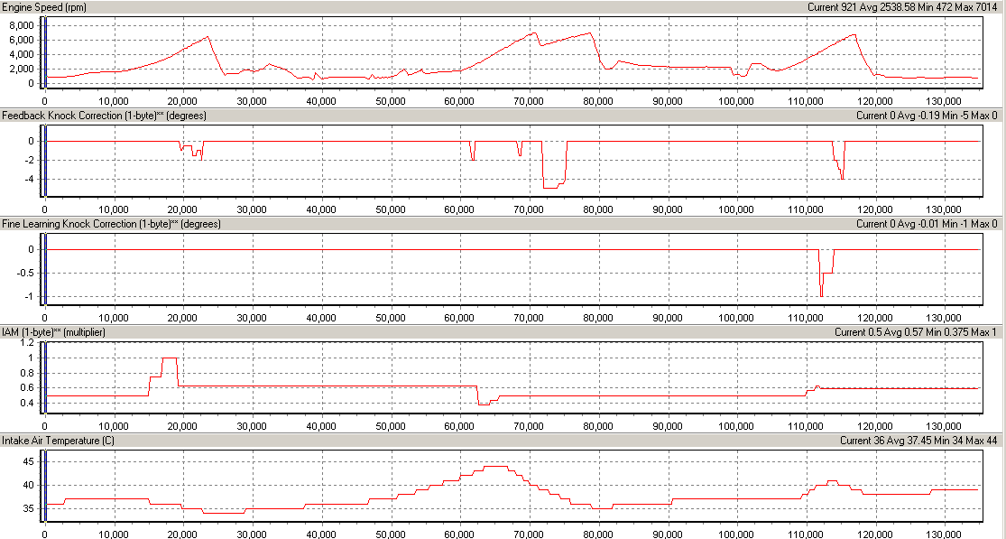

v1 Stats.png (20.83 KiB) Viewed 12024 times

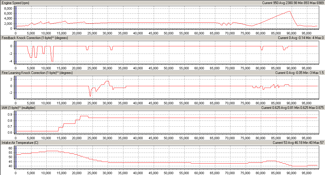

v2 Stats.png (24.63 KiB) Viewed 12024 times

Re: Raptor - 2006 ADM Subaru Liberty 3.0R 6MT - Tuning
Posted: Sun Oct 16, 2011 8:27 am
I am working with the owner to attain consistent dynoes.
To start from the same location, same direction and a car that is not heat soak.
