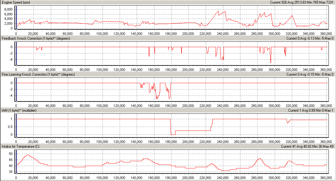

Stock Stats

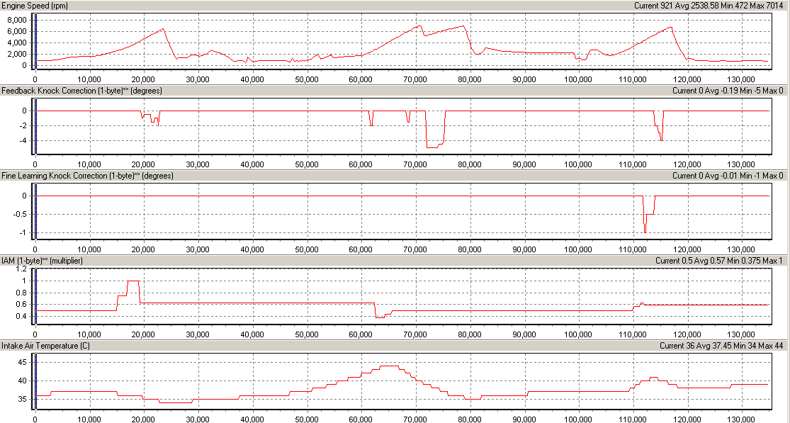

Stock stats.png (19.81 KiB) Viewed 11990 times

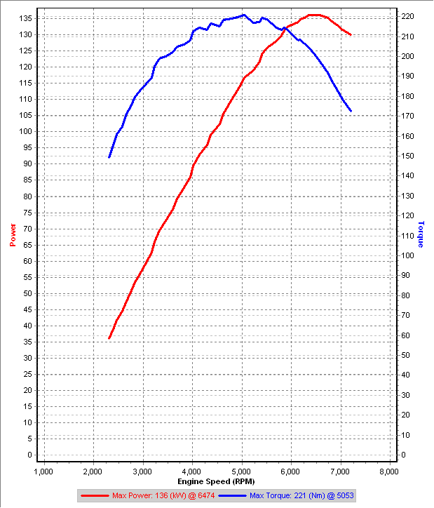

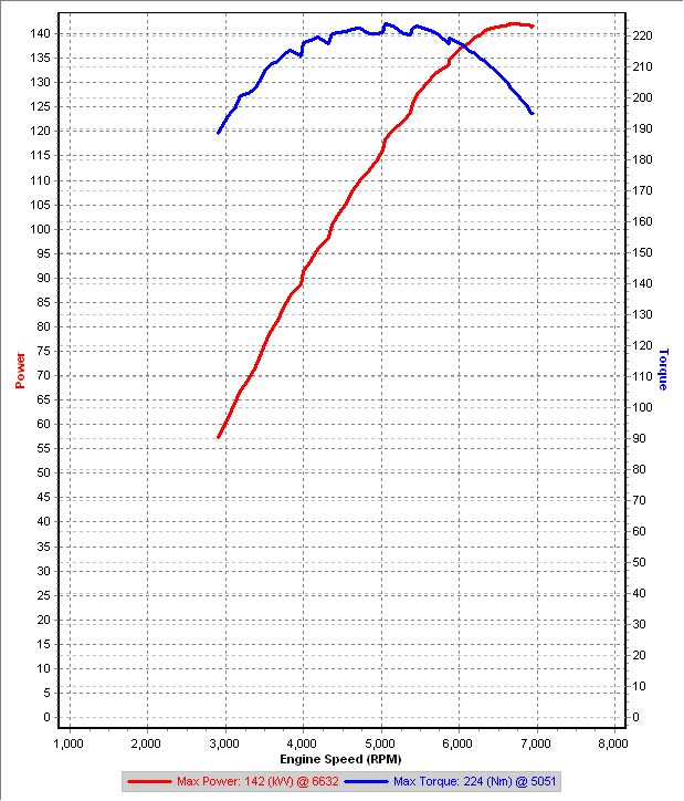

Stock 3rd Gear Dyno IAT=40C.png (16.74 KiB) Viewed 11990 times

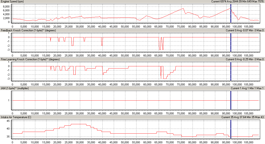

v0a Stats.png (23.17 KiB) Viewed 11990 times

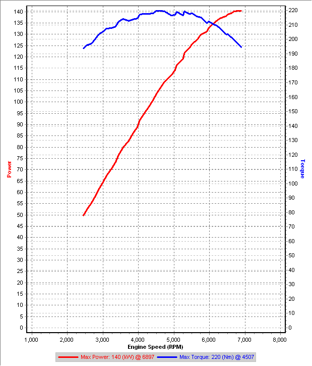

v0a 3rd Gear Dyno IAT=46C.png (16.38 KiB) Viewed 11990 times

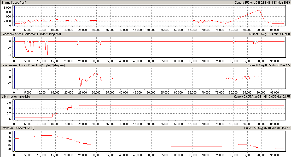

v1 Stats.png (20.83 KiB) Viewed 11990 times

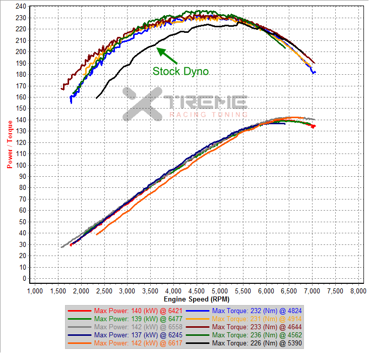

Raptor Headers v2
No tuning on the test headers
Stock Dyno vs v3c Dyno Header v2.png (53.53 KiB) Viewed 11808 times
