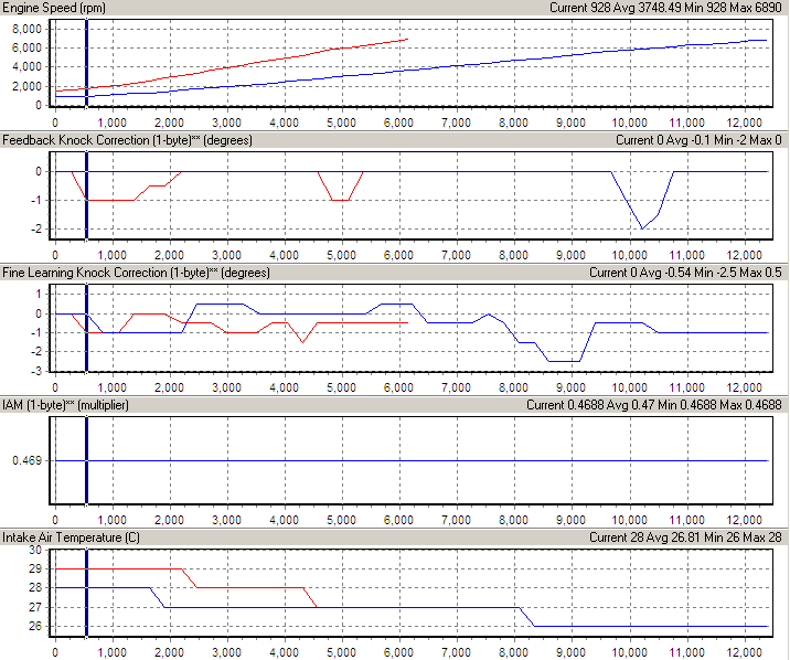

All dyno'es are based on RPM.
Posted: Wed May 11, 2011 8:25 am
- Stock Performance - 2nd & Third Gear.png (18.36 KiB) Viewed 24363 times

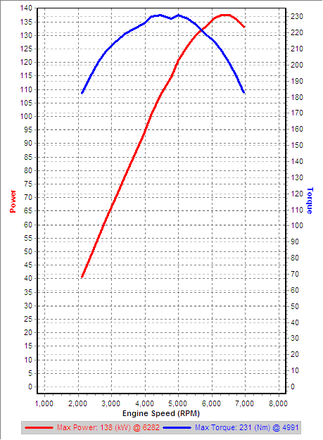

- Stock 2nd Gear Dyno IAT=28C.png (15.7 KiB) Viewed 24360 times

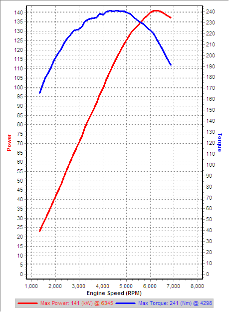

- Stock 3rd Gear Dyno IAT=27C.png (16.16 KiB) Viewed 24360 times

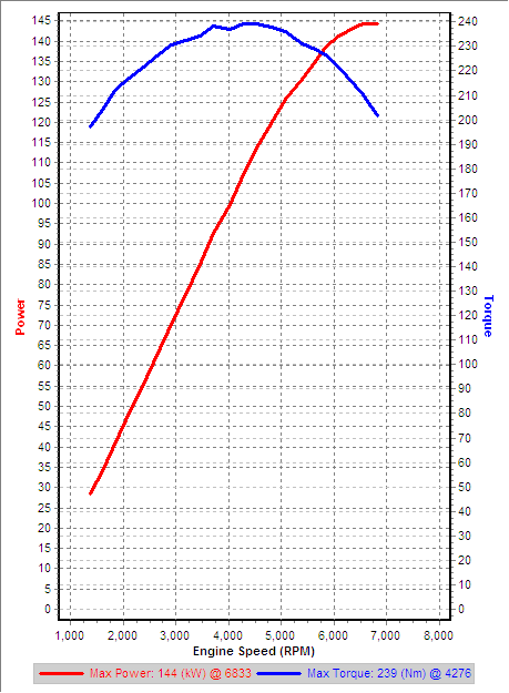

- v0 2nd Gear Dyno IAT=26.5C.png (15.89 KiB) Viewed 24355 times

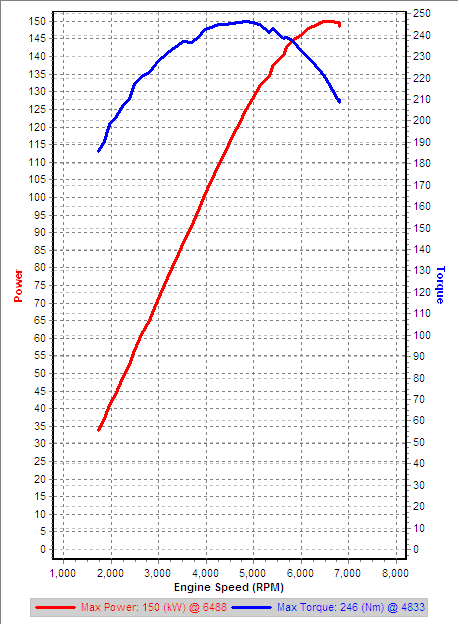

- v0 3rd Gear Dyno IAT=28.5C.png (16.07 KiB) Viewed 24355 times

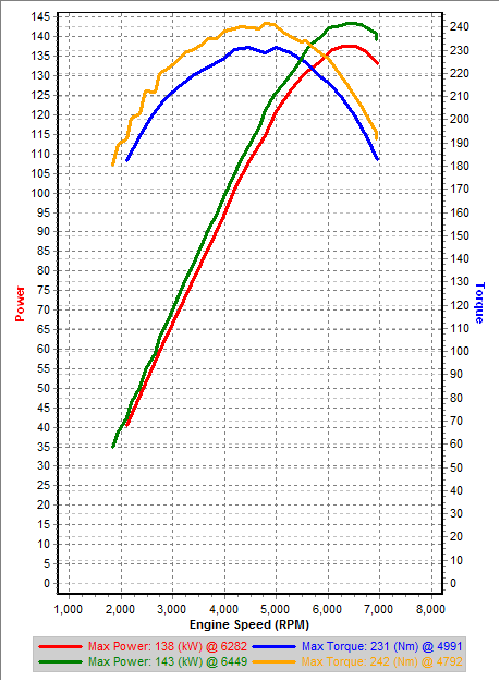

- Stock IAT=28C vs v5 IAT=24C - 2nd Gear Dynos.png (18.44 KiB) Viewed 24293 times

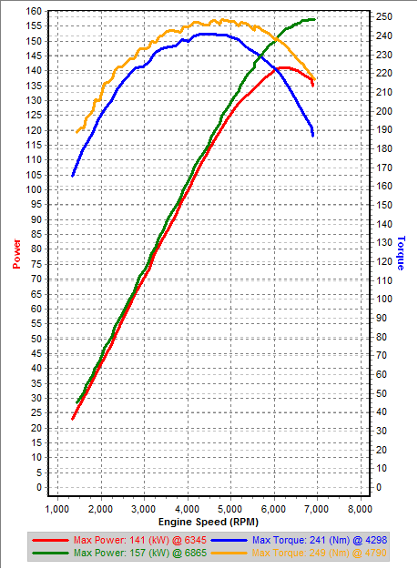

- Stock IAT=27.5C vs v5 IAT=24c - 3rd Gear Dynos.png (19.27 KiB) Viewed 24293 times
