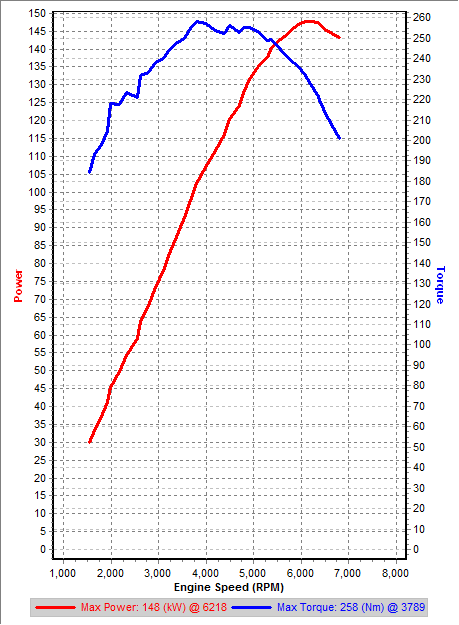

Stock Performance - 2nd & Third Gear.png (18.36 KiB) Viewed 24334 times
2nd Gear Dyno
Stock 2nd Gear Dyno IAT=28C.png (15.7 KiB) Viewed 24331 times

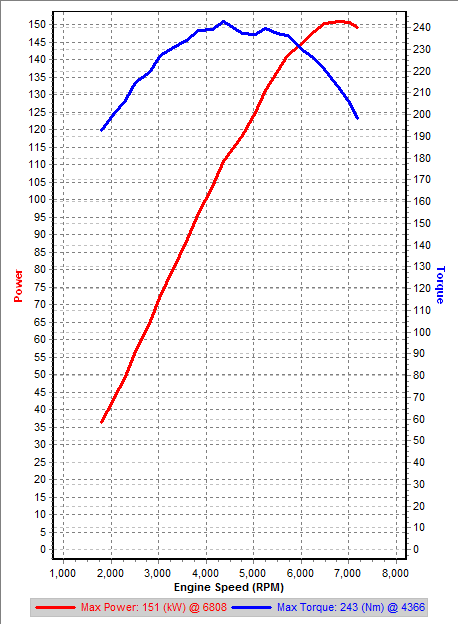

3rd Gear Dyno
Stock 3rd Gear Dyno IAT=27C.png (16.16 KiB) Viewed 24331 times

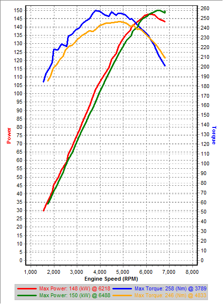

Stock IAT=28C vs v5 IAT=24C - 2nd Gear Dynos.png (18.44 KiB) Viewed 24264 times

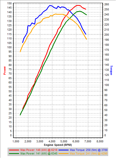

Stock IAT=27.5C vs v5 IAT=24c - 3rd Gear Dynos.png (19.27 KiB) Viewed 24264 times

I've been very happy with all aspects of the service Edward has provided. Considering the time difference he's always been very quick to respond to any questions or updates I've sent. The car now feels much more responsive, more powerful, and more linear especially at the top end. The last 1000rpm is actually useful now! The DBW changes have made it easier for me to drive, as i'm used to a more sensitive throttle. The service came recommended to me, and I would recommend it to others as well.
