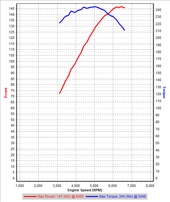

2nd Gear Dyno Stock IAT=25C.png (16.12 KiB) Viewed 13351 times
Still downhill in the end, which would rise power a bit
3rd Gear Dyno Stock IAT=20C.png (16.7 KiB) Viewed 13350 times

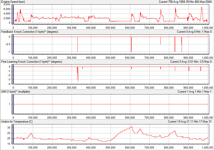

Stock performance.png (19.61 KiB) Viewed 13351 times
