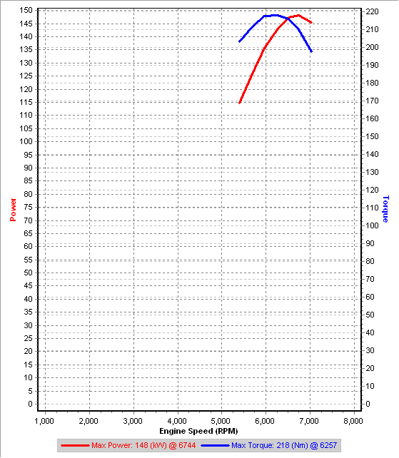

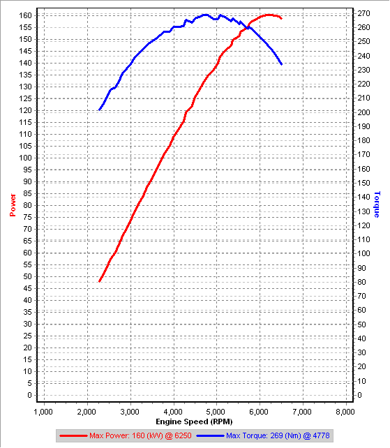

Posted: Sun Feb 07, 2010 9:45 pm
Stock 3rd Gear Dyno IAT=15.5C.png (14.56 KiB) Viewed 21750 times
v0 Results

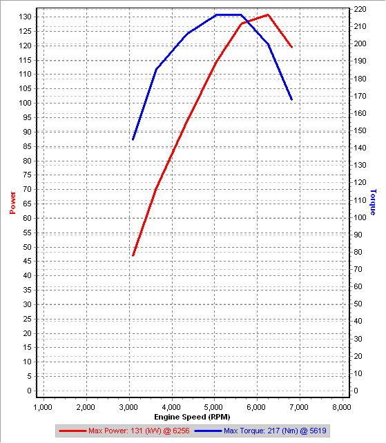

Posted: Mon Feb 08, 2010 1:35 am
I like how you drive. I will show this to my students, to see if their can pick up how you drive. I am trying to teach them tuning without driving a car. Just tune from Logs!!! Lol.
v0 3rd Gear Dyno IAT=7C.png (14.68 KiB) Viewed 21750 times

v2 Stats

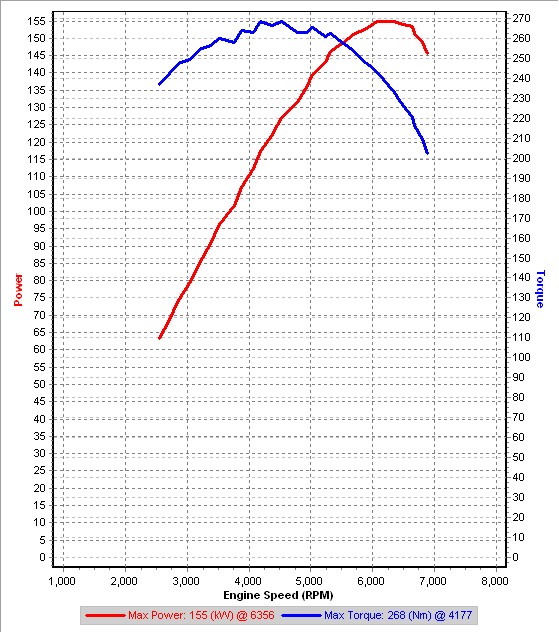

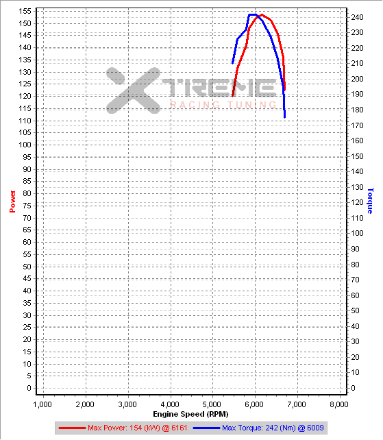

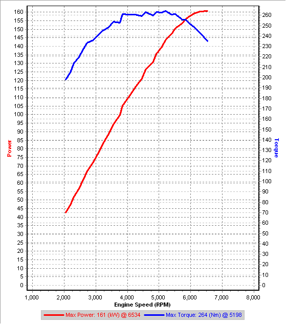

Posted: Wed Feb 10, 2010 2:22 am
v2 1st Gear Dyno IAT=9C.png (14.4 KiB) Viewed 21744 times
v2 2nd Gear Dyno IAT=9C.png (12.9 KiB) Viewed 21744 times
v2 4th Gear Dyno IAT=7C.png (14.85 KiB) Viewed 21744 times

v3 Stats

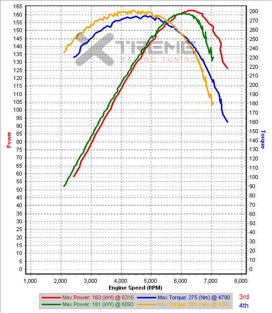

Posted: Sat Feb 13, 2010 7:20 pm
v3 2nd Gear Dyno IAT=10C.png (16.91 KiB) Viewed 21737 times
v3 3rd vs 4th Gear Dyno IAT=8C.png (22.27 KiB) Viewed 21737 times
Tuning is almost completed just for cold weather. Further tuning will be needed for hot weather.
