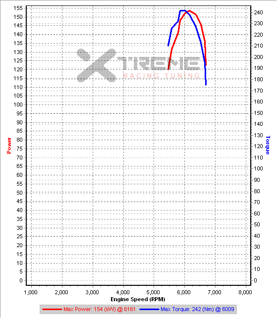

Stock Performance at Temperatures below 16C
Stock 3rd Gear Dyno IAT=15.5C.png (14.56 KiB) Viewed 21725 times
v0 Results
I like how you drive. I will show this to my students, to see if their can pick up how you drive. I am trying to teach them tuning without driving a car. Just tune from Logs!!! Lol.

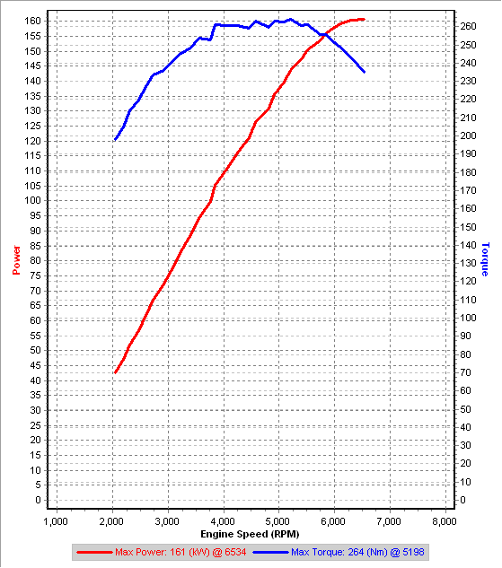

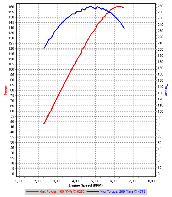

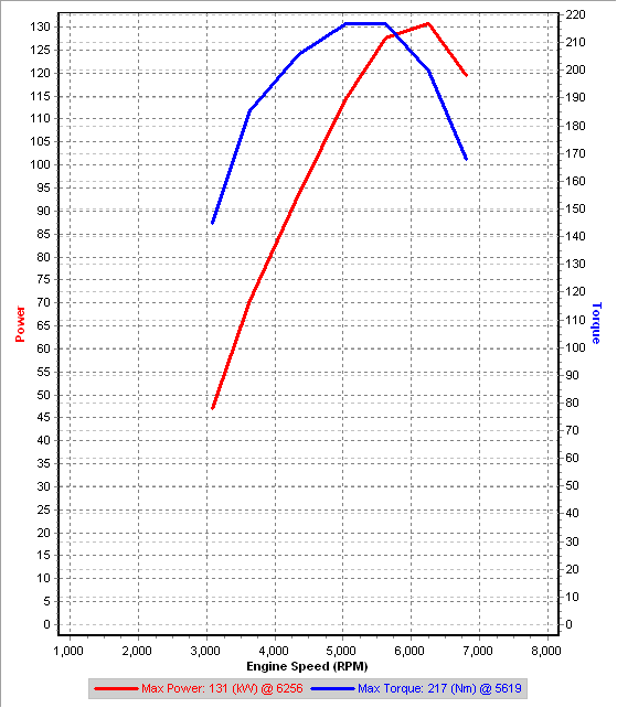

v2 ROM has improved the linear throttle response without the sudden but exciting AVCS. No flat spots or hesitancy for everything above 2000rpm
Looking forward to seeing the Dyno chart.
Interested in raising the RPM limiter to maybe 7500 for the next version perhaps.
v2 Stats
v2 1st Gear Dyno IAT=9C.png (14.4 KiB) Viewed 21719 times

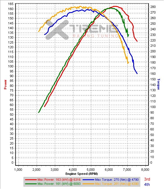

v3 Stats
v3 2nd Gear Dyno IAT=10C.png (16.91 KiB) Viewed 21712 times
v3 3rd vs 4th Gear Dyno IAT=8C.png (22.27 KiB) Viewed 21712 times
Tuning is almost completed just for cold weather. Further tuning will be needed for hot weather.
