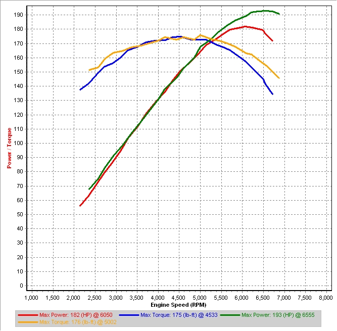

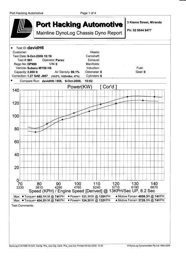

Stock Landbase Dyno
My05 ADM 3R - Stock.png (97.55 KiB) Viewed 24800 times

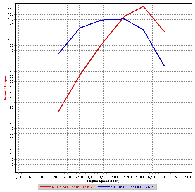

Software Dyno
Stock 3rd Gear Dyno #1 20090617.jpg (282.27 KiB) Viewed 24851 times
Based on rpm

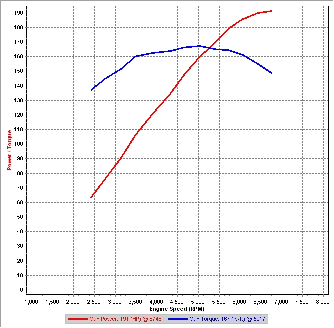

Stock 3rd Gear Dyno-s #1 20090617.jpg (278.79 KiB) Viewed 24851 times
Based on speed

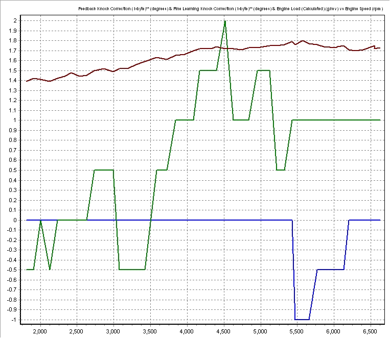

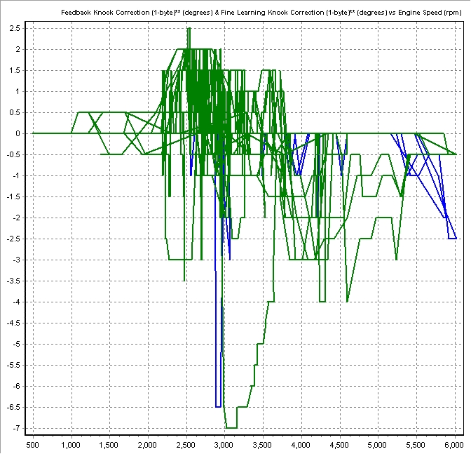

Stock driving performance
Stock Driving Performance.png (23.74 KiB) Viewed 24801 times
Stock Performance - FLKC-FKC.jpg (299.47 KiB) Viewed 24827 times
