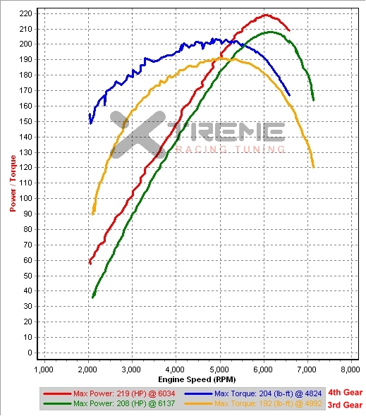

Stock 3rd and 4th gear Dyno comparison - Turboback
Stock 3rd and 4th gear Dyno comparison #2 - Turboback.jpg (223.43 KiB) Viewed 41249 times

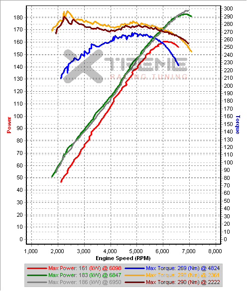

v21 4th Gear Dyno's comparisons IAT=28-29C
Posted: Sun Jan 03, 2010 10:43 am
Lastest stats before Fuel map changes
Stock 4th Gear vs v21 4th Gear Dyno
Posted: Sun Jan 03, 2010 6:06 pm
Stock 4th Gear vs v21 4th Gear Dyno.png (19.5 KiB) Viewed 41235 times
