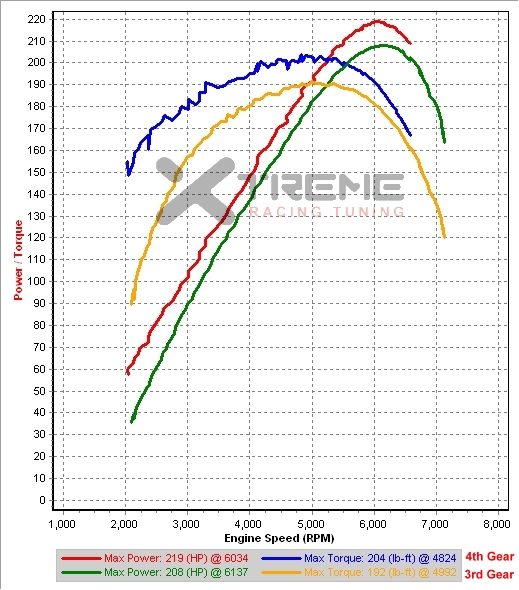

Stock 3rd and 4th gear Dyno comparison - Turboback

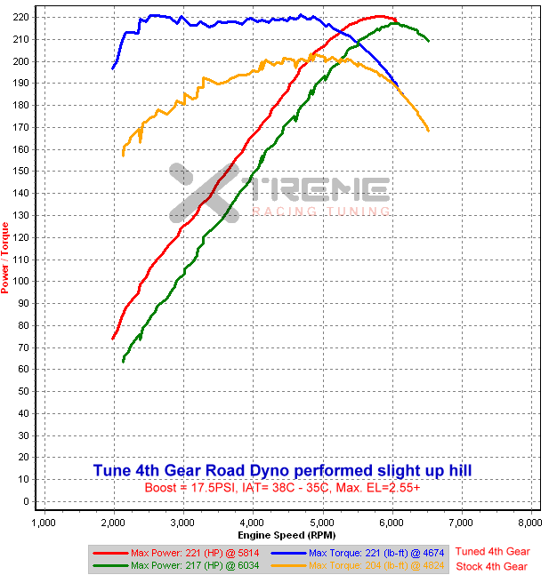

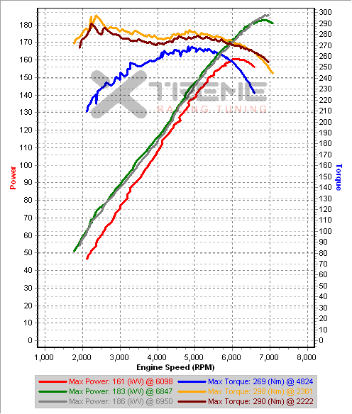

Tuned 4th vs Stock 4th Gear Dyno's
- Attachments
- Tuned vs Stock - 4th Gear Dyno.png (29.51 KiB) Viewed 41471 times

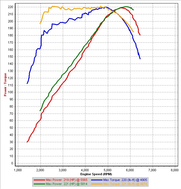

Intake VVT Tuning
- Attachments
- 1-19 c vs d-vvt 4th Gear Dyno's.jpg (157.51 KiB) Viewed 41471 times

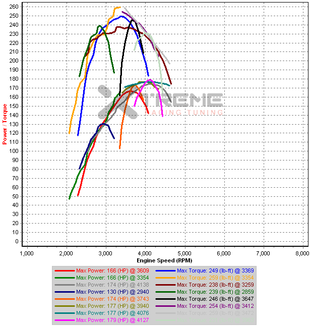

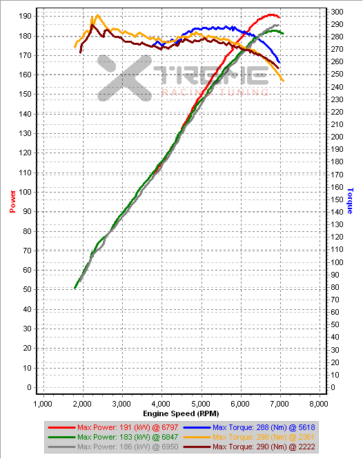

4th Gear Dyno Comparison
- Partial 4th Gear runs performed around 9am+[/*}
- Continue 4th Gear operation on the road
- Intake Air temperatures (IAT) at the MAF ranges: 36C - 32C
- Average boost: 18psi
- Additional Intake VVT Tuning. Some Exhaust VVT Tuning
- Minor Fuel changes
- Minor additional Ignition tuning
- Max. Engine Load: 2.7+ (g/rev)
- Attachments
- 1-19e3-vvt 4th Gear Dynos.png (24.29 KiB) Viewed 41471 times

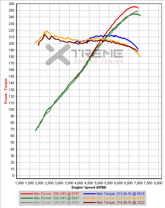

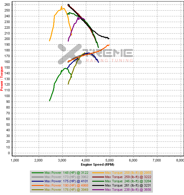

5th Gear Dyno Comparison
- Partial 5th Gear runs performed around 9am+[/*}
- Continue 5th Gear operation on the road
- Intake Air temperatures (IAT) at the MAF ranges: 41C - 32C
- Average boost: 17.5psi
- Max. Engine Load: 2.9+ (g/rev) Avg: 2.6 (g/sec)
- Attachments
- 1-20 5th Gear Dyno's.png (21.76 KiB) Viewed 41471 times

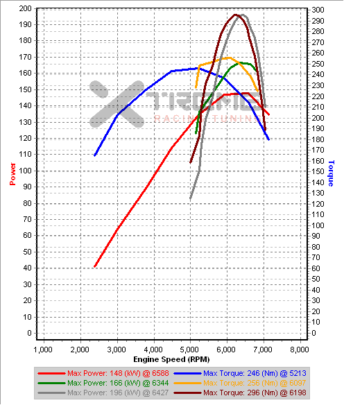

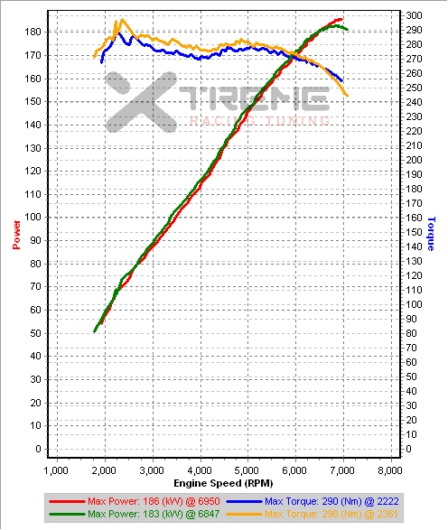

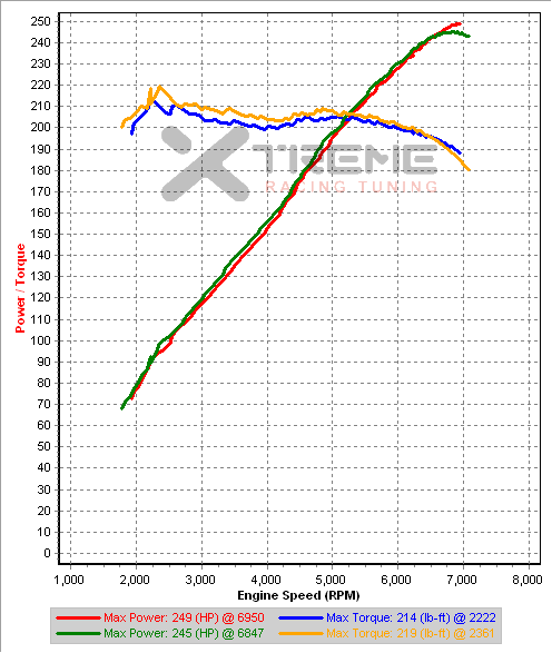

v21 4th Gear Dyno's comparisons IAT=28-29C
Lastest stats before Fuel map changes
- Attachments
- 's comparisons IAT=28-29C kw.png (17.7 KiB) Viewed 41440 times
- 's comparisons IAT=28-29C.png (15.62 KiB) Viewed 41440 times
