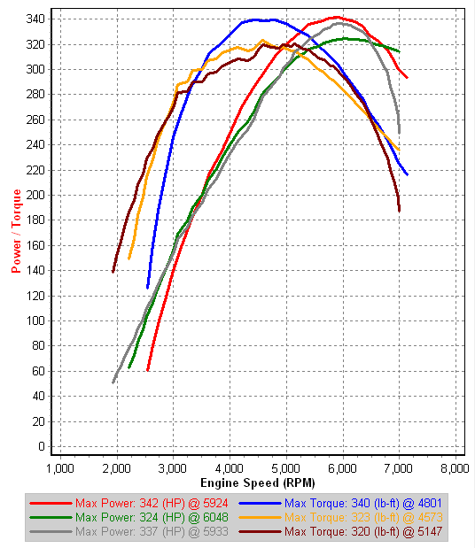

The higher number is the WI car.
It must be noted that WI RA fuel map is not optimise like the other RA map. If so, the WI car would have posted greater WHP.
The non WI (Water Injection) ran 11.5afr @ TQ and 12.2-12.0afr @ HP
XRT - WI RA vs RA, Stage R Tuned
- Attachments
- Compare Hermant to Hyper WI RA .png (16.92 KiB) Viewed 11253 times
