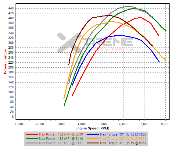

Cosworth AVCS Cams
GT3071R Twin-Scroll Turbo running 23psi with 17.5psi WG Spring
Apexi High Flow Panel Intake Filter (stock intake box)
PE800cc Injectors
Walbro Pump
Exhaust system
Hyper, you can notify on any corrections above.
Real Dyno can be up to 40whp less, but the graphs are very heavily smoothed.
Yellow & Red represents 4th Gear, while Orange and Green represents 3rd gear.
Hydra Drag RA 3th & 4th Gear Dynoes

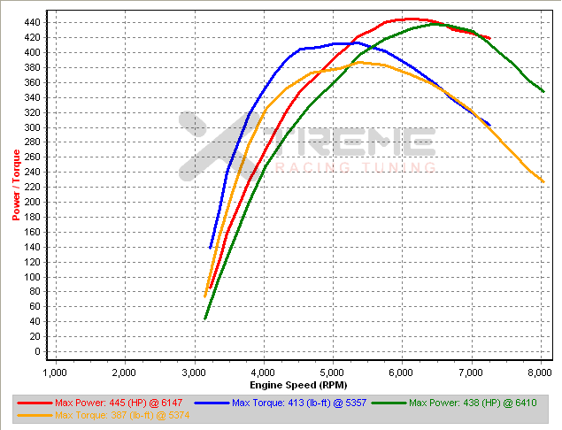

Same as above, but I added the 2nd gear to the graph.
Looking at the info table and starting from the top, results for 2nd, 3rd and 4th gear respectively.
