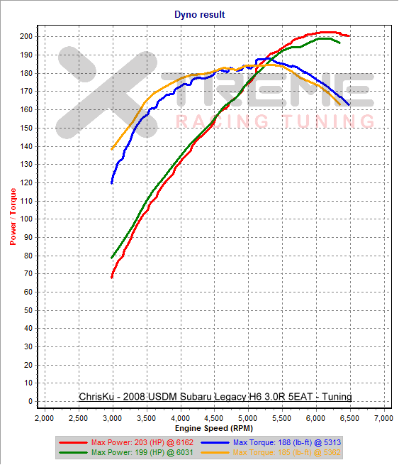

v31b 2nd Gear Dyno SAE #1.png (29.35 KiB) Viewed 33465 times

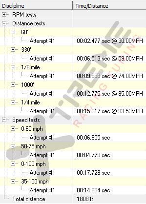

v32d - Drag Gear Pull - Imperial.png (27.93 KiB) Viewed 33222 times

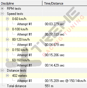

v32d - Drag Gear Pull - metric.png (13.91 KiB) Viewed 33222 times
