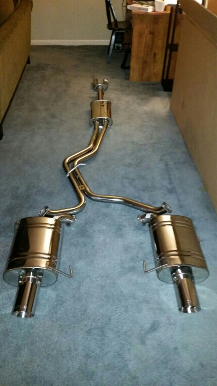

- K2 Gear Spec Neo Full Dual Center Pipe & Xforce Sports Mufflers *Catback Portion*
- 2015-08-05 21.47.06.jpg (222.39 KiB) Viewed 81565 times

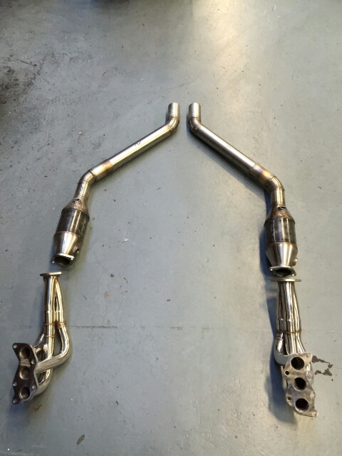

- Raptor Headers & High Flow Cat Combo*Made By ChargerTech NL*
- 2015-08-05 21.48.21.jpg (217.7 KiB) Viewed 81565 times

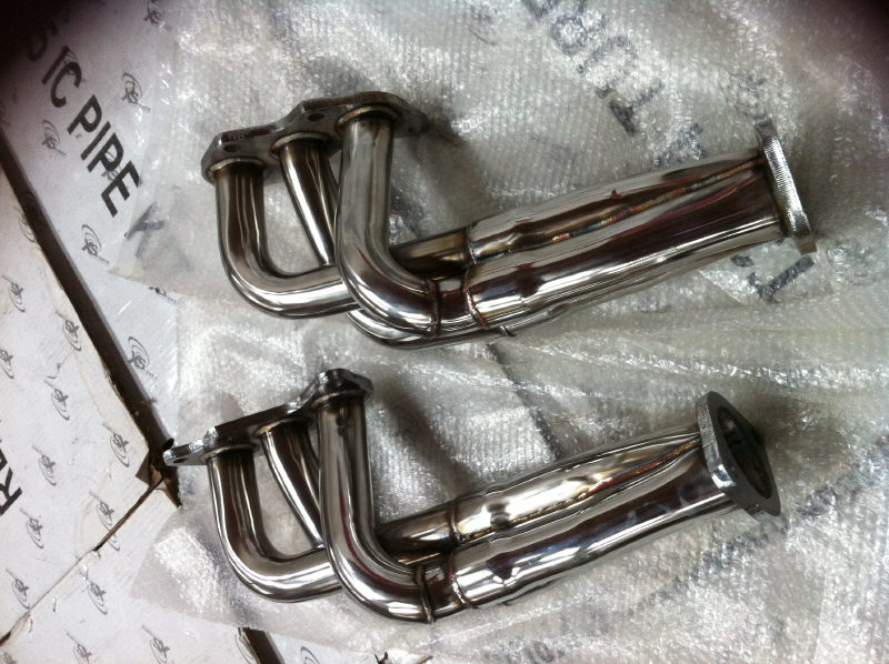

- Raptor Headers
- file-1.jpeg (118 KiB) Viewed 81565 times

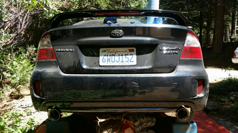

- CatBack Portion Installed
- 2015-08-05 21.56.58.jpg (312.85 KiB) Viewed 81565 times
