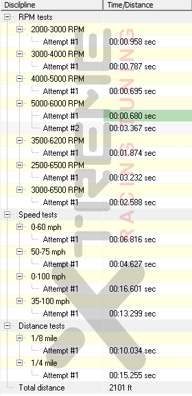

vprmfmv27 - Race Stats on Chevron 91 | Elevation = 1910ft
Posted: Mon Oct 12, 2015 8:11 pm
More tuning done
Elevation: 1910Ft
Barometer: 13.64psi
Re: vprmfmv27 - Race Stats on Chevron 91 | Elevation = 1910f

These times make me very happy! They are all faster times on the 0-60mph, 0-100mph and 1/4mile times on ROM v27 vs V26! The rallymax is working! going to do a little more testing to optimize the rallymax mixture with ed, but so far so good! This rallymax additive, especially up in the mountains is helping i feel in a big way! the pinging looked like it went down as well too!
v26 vs v27
0-60mph 7.6sec / 0-60mph 6.8sec
0-100mph 17.8sec / 0-100mph 16.6sec
1/4mile 15.9sec / 1/4mile 15.2sec

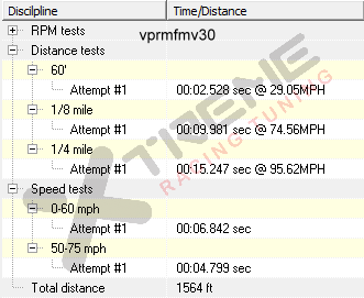

vprmfmv30 - Race Stats - Chevron 91 | Elev. 1910Ft
Posted: Mon Oct 26, 2015 1:34 am
Elevation: 1910Ft
Barometer: 13.64psi (27.77inHg)

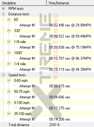

vprmfmv31 - Drag Times | Altitude 970Ft
Posted: Sat Oct 31, 2015 8:08 am
Elevation: 970Ft
Barometer: 14.22psi (28.95inHg)
v31 Drag Times - 970ft Altitude.png (11.83 KiB) Viewed 37638 times
v31 Drag Times (RPM) - 970ft Altitude.png (12.85 KiB) Viewed 37638 times

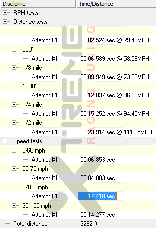

Another Drag pull up to 1/2 mile
v31 Drag Times #2 - 970ft Altitude.png (13.17 KiB) Viewed 37635 times

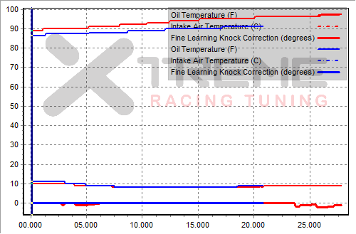

I am not sure if the Oil temperature sensor was reading right. Was under 92F in those pulls although the coolant was 90. But when it got over 100 to 200F, then pinging and reduce power
Justification for better oil and oil cooling.png (13.66 KiB) Viewed 37635 times
Now if you continue to drive like this, you will have to change the oil, but you are in winter. But a full racing oil will be ok for you. Example Motul 300v. It will allow you to driver harder and longer, even at higher rpm to the limit.
I will also encourage you to get a patent oil cooler like the STI or Cusco ones.
