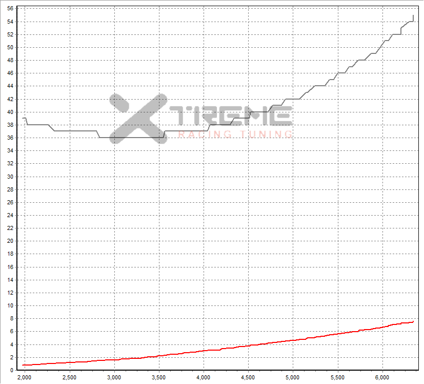

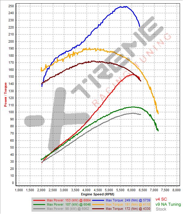

v4 SC
Posted: Sat Sep 15, 2012 9:22 am
v4 SC Dyno.png (68.94 KiB) Viewed 25659 times

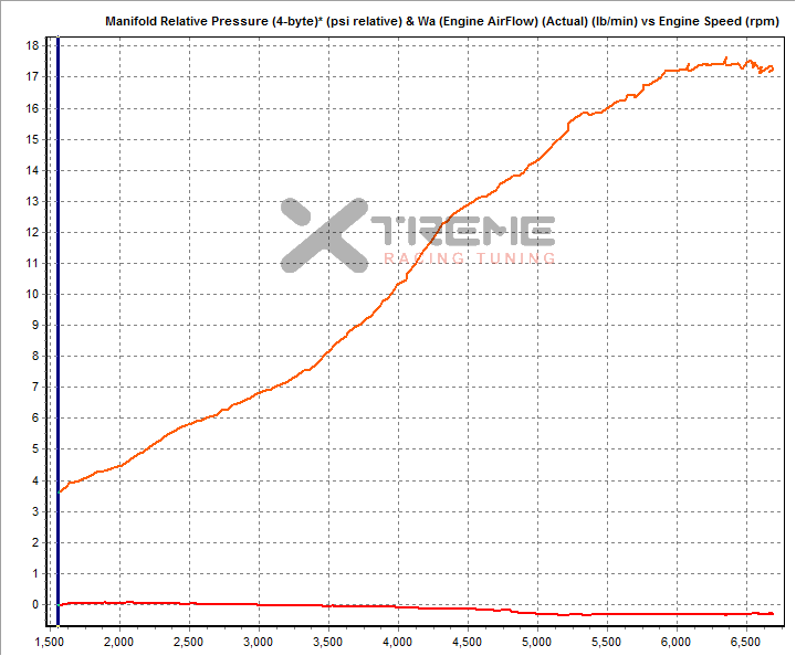

v4 SC Dyno - MRP_IAT.png (25.38 KiB) Viewed 25659 times

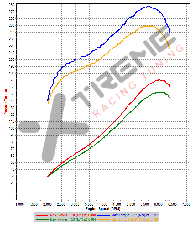

Old boost vs New Boost
Posted: Wed Oct 24, 2012 6:43 am
I believe the car have a leak in the intake system and maybe around the injectors. Customer been notified
SC Boost Comparison - 3rd Gear Dyno SAE.png (56.24 KiB) Viewed 25600 times

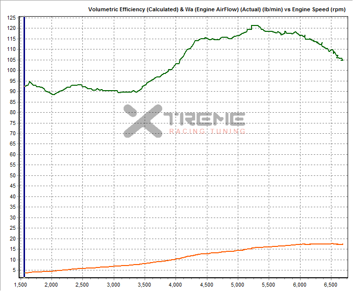

v14 XRT NA Tuned - Wa & VE
Posted: Sat Mar 16, 2013 10:54 am
Volumetric Efficiency
V14 XRT NA Tuned VE.png (18.56 KiB) Viewed 25384 times

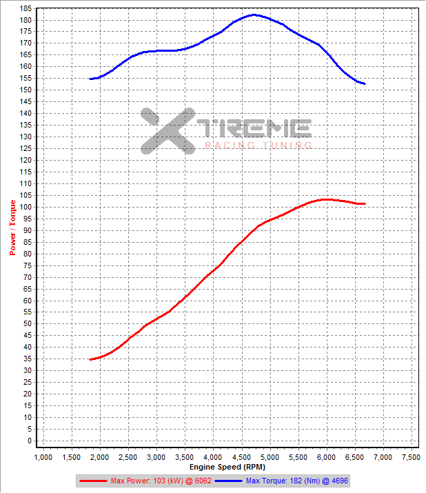

v14 XRT NA Tuned 3rd Gear Dyno SAE
V14 XRT NA Tuned 3rd Gear Dyno SAE.png (19.56 KiB) Viewed 25384 times

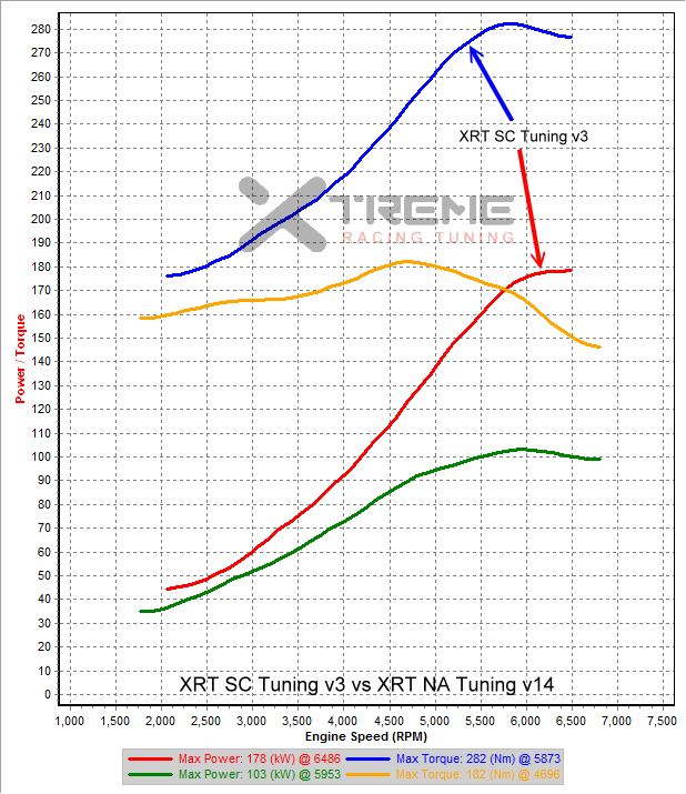

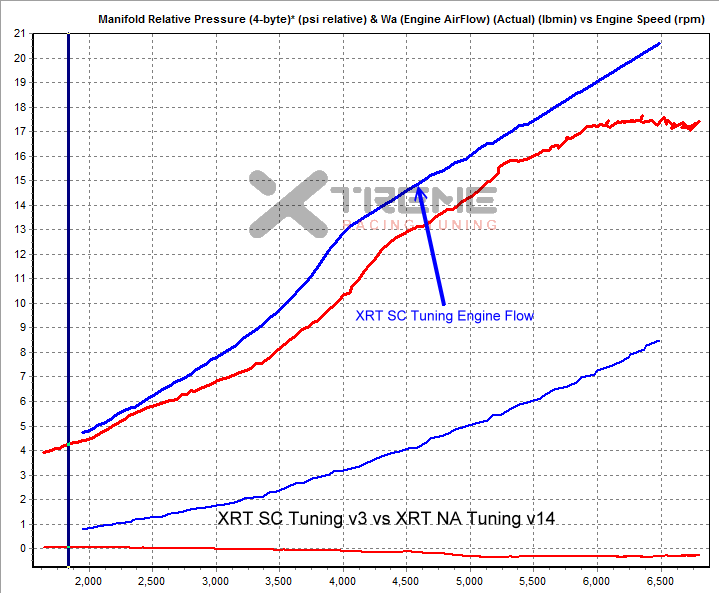

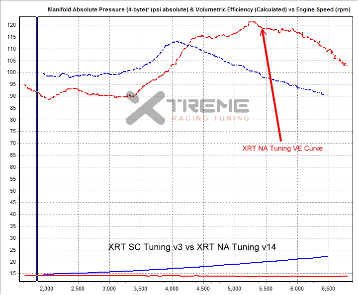

XRT SC Tuning v3 vs XRT NA Tuning v14
Posted: Sat Mar 16, 2013 12:33 pm
XRT SC Tuning v3 vs XRT NA Tuning v14 #2.png (28.67 KiB) Viewed 25384 times
XRT SC Tuning v3 vs XRT NA Tuning v14 #1.png (29.56 KiB) Viewed 25384 times
XRT SC Tuning v3 vs XRT NA Tuning v14.png (31.76 KiB) Viewed 25384 times

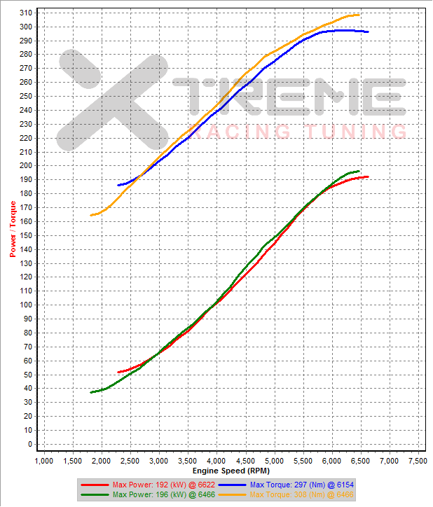

sc-sti_inj-v13 Stats
Posted: Tue Jun 18, 2013 7:04 am
sc-sti_inj-v13 - 3rd Gear Dynoes SAE sm=2 tm=120
sc-sti_inj-v13 - 3rd Gear Dynoes SAE sm=2 tm=120.png (26.59 KiB) Viewed 25211 times

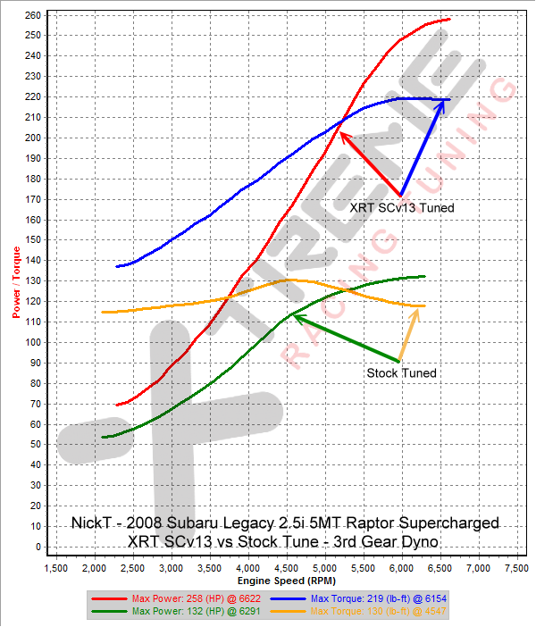

XRT SCv13 vs Stock Tune
Posted: Sun Feb 23, 2014 6:34 pm
XRT SCv13 vs Stock Tune - 3rd Gear Dyno SAE whp.png (75.12 KiB) Viewed 24907 times

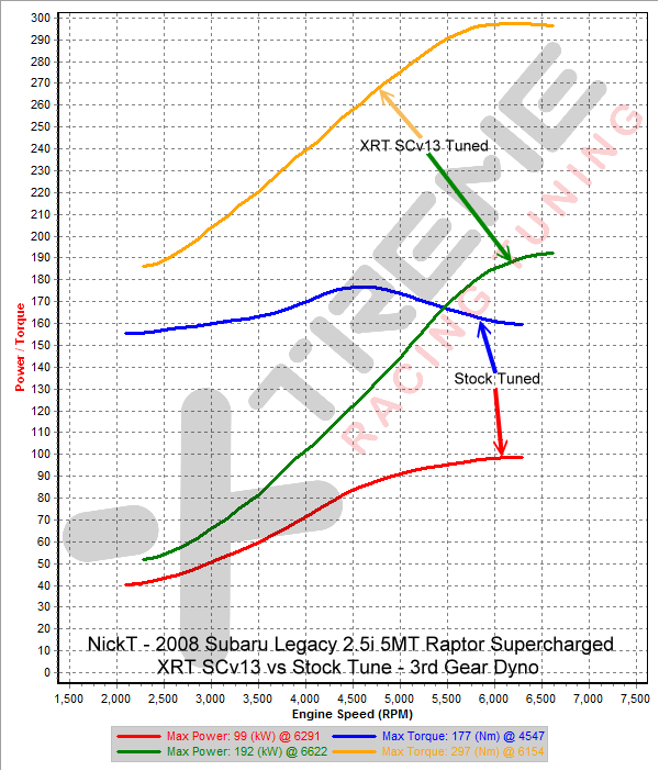

XRT SCv13 vs Stock Tune - 3rd Gear Dyno SAE.png (69.65 KiB) Viewed 24918 times
