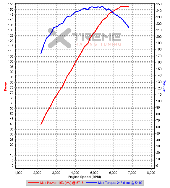

5c1 3rd Gear Dyno @ IAT=22C #1.png (18.76 KiB) Viewed 19759 times
5c1 3rd Gear Dyno @ IAT=22C #1 kw.png (20.5 KiB) Viewed 19759 times

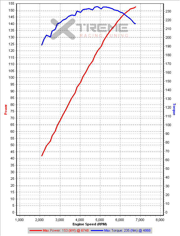

Due to the environmental changes, it is very hard to say that power has increase substantially or to a noticeable amount. What has change in respect to the owners feedback is that the car has become responsive and the DBW performance has improved.
AVCS tuning, unless more is perform where we run less for testing, has showed no improvement and the maximum map set of 50 seems to be the max it will go. I would pretty say the car is max out as it is. I am not sure of the other markets, including JDM, but modifying it and working the Ignition map for the gas it runs now, makes the car very consistent.

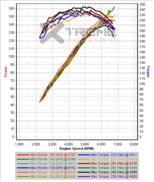

v8 3rd Gear Dyno Comparisons
v8 3rd Gear Dyno Comparisons.png (23.1 KiB) Viewed 19755 times

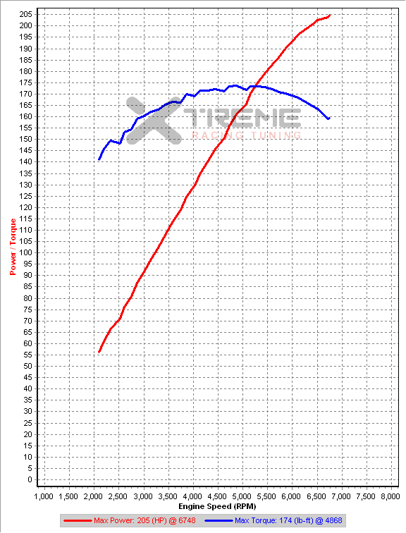

v11c 3rd Gear Dyno's Stats
Posted: Sun Jan 03, 2010 9:59 am
's Comparisons - IAT=22 - 23.5C.png (21.61 KiB) Viewed 19742 times

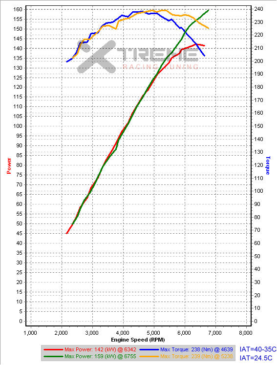

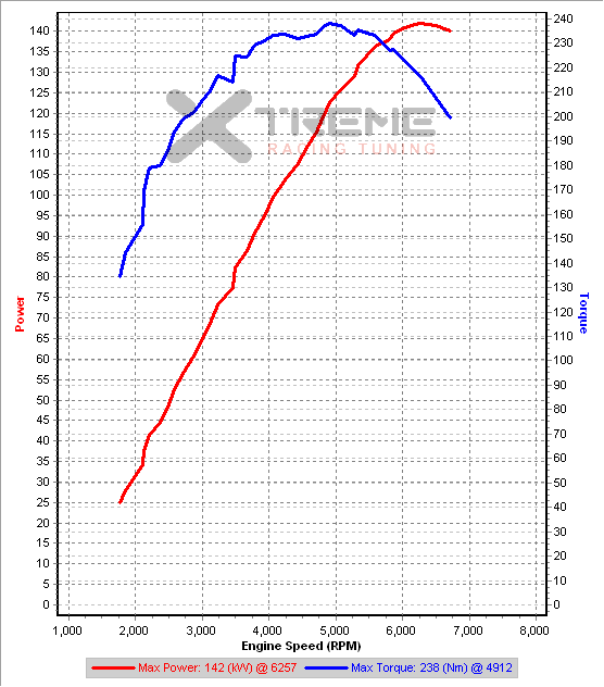

v11c6 3rd Gear Dyno IAT=63-45C
Posted: Mon Feb 01, 2010 1:40 am
v11c6 3rd Gear Dyno IAT=63-45C.png (18.67 KiB) Viewed 19716 times

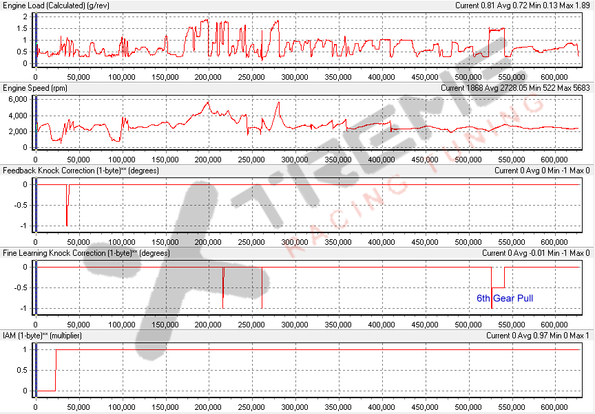

v13 Final Stats - Tuning Finish
Posted: Tue Feb 02, 2010 9:39 pm

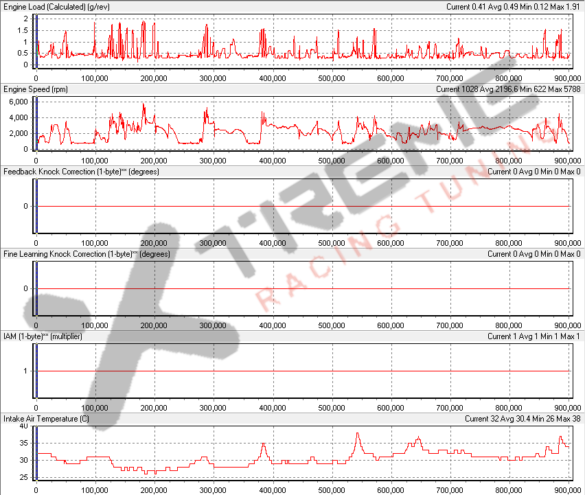

BlackFlatSix05 - v13 Final tuning stats.png (75.1 KiB) Viewed 19715 times
v13 3rd Gear Partial Dyno IAT=31C.png (18.56 KiB) Viewed 19715 times

Tuning is now complete for my car.
All I can say is I am more than happy with the service Edward has provided. The final rom was V13. To arrive at this there were many versions. I have 29 saved however, there may have been more that I didn't bother to save.
Many hours of flashing and way too many logs of the various versions/revisions of the roms have been completed to arrive at what we have now.
What was learned along the way is these cars are no where near their full potential from the factory and suffer from fuel pick up problems below half a tank and also spark plugs could do with a change at 50,000km not 100,000 as recommended by Subaru.
I now have zero knock/pinging in my logs and the IAM is constant now at 1 so there is no timing being constantly pulled by the ecu and the car is running at it's absolute best for our fuel and atmospheric conditions.
Compared to how it was before Edward's efforts it is ballistic for a stock 05 3.0RB. It's not like my old WRX but a hell of a lot better than before.
For my last rom Edward tweaked the DBW a little more which has made the car more lively and fun to drive. Edward could tell from the logs that I heal and toe. The DBW changes have made this easier as the throttle responds to slight applications.
