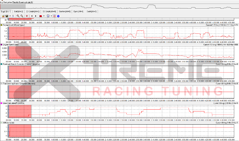

v19a Partial Critical Data
Posted: Sun Aug 23, 2015 5:15 pm
Current operations is running a gas mixture to reduce pinging. AVCS-Left still laggy.

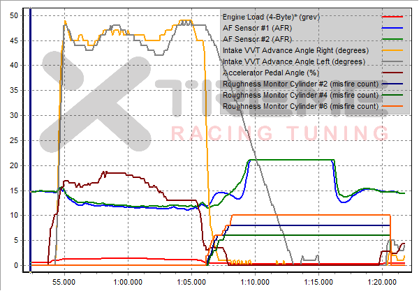

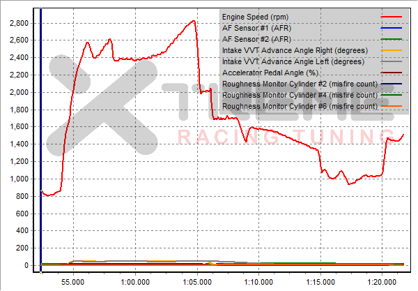

Missing Firing
Posted: Sat Aug 29, 2015 7:16 am
Missing only occurring when the below graph conditions are met at deceleration under 3000rpm or for sure 2000rpm when AVCS is non zero or at its max value of 40-50 degrees advance. The Left AVCS is causing the issue, allow air more air that usual into the left side of the Head, causing lean conditions. In addition due to pass logs, this side is a tab leaner sometimes. Injectors should be flow tested, including any vacuum leaks checked.
FYI:
http://www.engine-misfire.com/
http://www.autotap.com/techlibrary/diag ... sfires.asp
http://www.random-misfire.com/
Critical_data - Subaru_H6_3R_Miss-Firing_Caused_by_AVCS-L.png (26.62 KiB) Viewed 39559 times
Critical_data - Subaru_H6_3R_Miss-Firing_Caused_by_AVCS-L - RPM.png (21.18 KiB) Viewed 39559 times

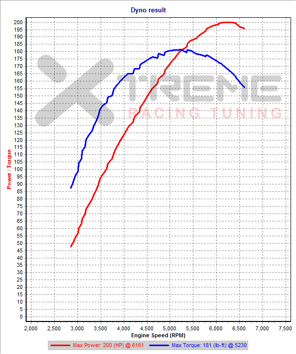

v20a1 - 2nd Gear Dyno SAE - 4000Ft Elevation
Posted: Mon Sep 07, 2015 8:32 am
Subject: V20a1 logs
Date: Sun, 6 Sep 2015 21:26:31 -0700
From: ChrisK
she felt VERY smooth on the power delivery n smooth overall...
Honestly felt really good in automatic and sport shifting modes in sport and sport sharp(#)
v20a1 - 2nd Gear Dyno SAE.png (26.18 KiB) Viewed 39684 times
