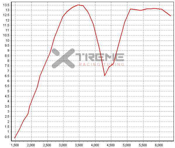

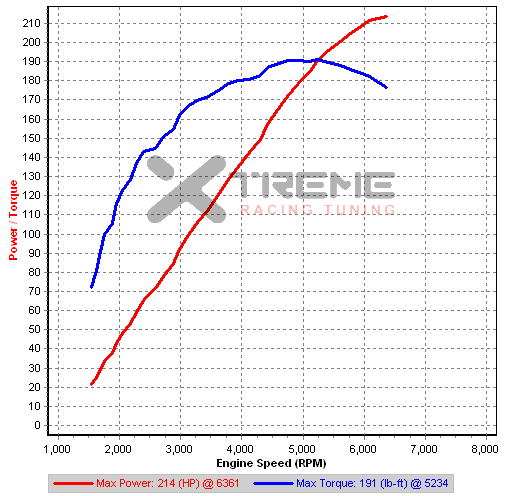

5MT Conversation 2nd Gear Dyno Data
Stock 5MT conversion 2nd gear Boost 20090416 - IAM=9 IAT=42C.png (14.04 KiB) Viewed 27378 times
Stock 5MT conversion 2nd gear Dyno 20090416 - IAM=9 IAT=42C.png (13.6 KiB) Viewed 27376 times

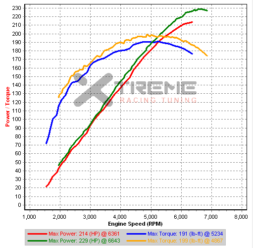

5MT 2nd vs 3rd Gear Dyno
Stock 5MT conversion 2nd vs 3rd gear Dyno 20090416 - IAM=9 IAT=42C.png (15.33 KiB) Viewed 27388 times

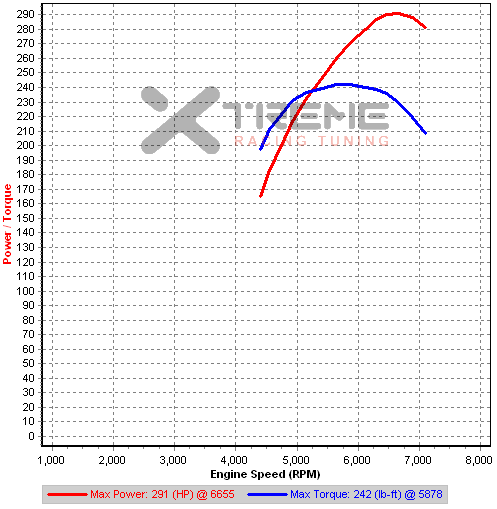

Dyno of just the Dual Operation in old tuning. XRT Tuning is done different in these modes in terms of the Fuel Map
17.5psi
Stage 1-5 2nd Gear Dyno - Boost=17.5psi SM=18 IAT=39C.png (13.17 KiB) Viewed 26113 times
19.3psi
Stage 2-4 2nd Gear Dyno Dual Operation - Boost=19.3psi SM=18 IAT=19C.png (13.27 KiB) Viewed 26114 times

What fuel is this running?
Re: 2003 JDM Subaru Legacy Twin Turbo Auto - BB
Normal pump gas Kosti. Maybe 90-92. Maybe as low as 89. But maybe 91. We have no clue in the Island. Their tell lies here. One gas comes in and is distributed. All behave different.
