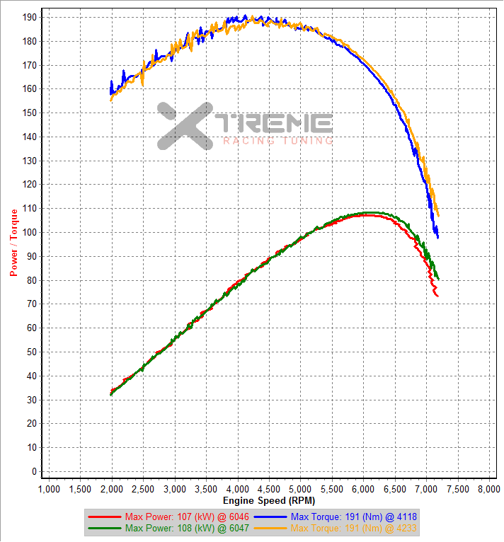

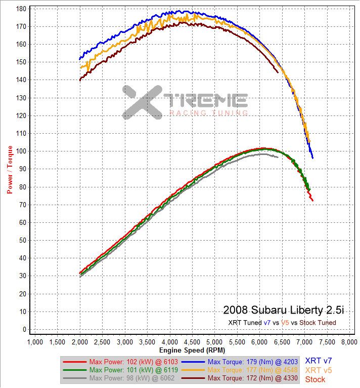

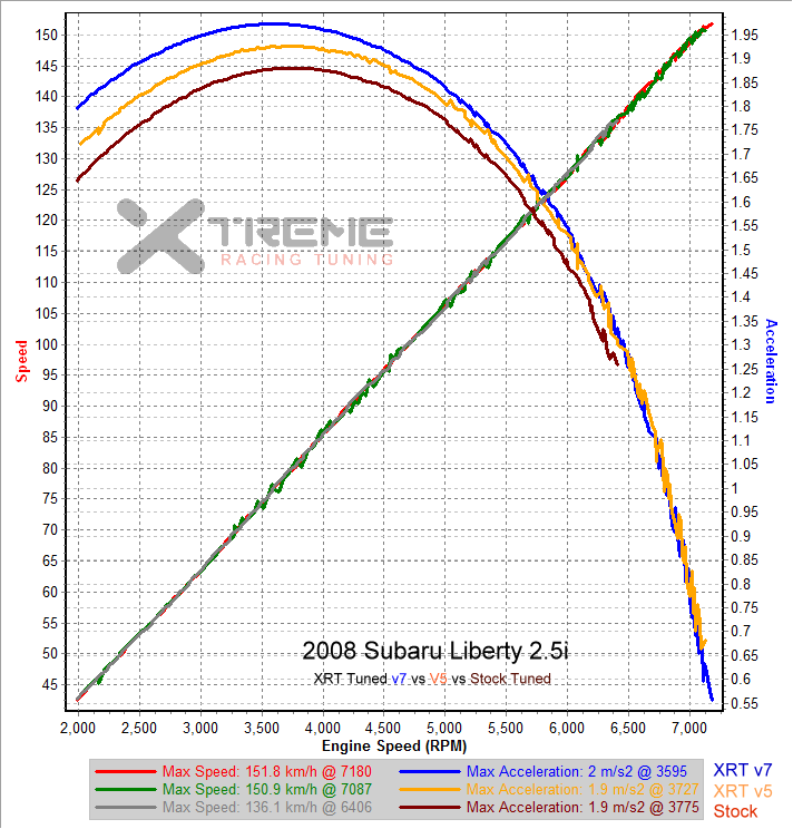

Posted: Wed Jul 25, 2012 7:55 am
V7 have greater low end torque
v7 3rd Gear Dyno SAE Accel.png (45.54 KiB) Viewed 25873 times
v7 3rd Gear Dyno SAE.png (42.22 KiB) Viewed 25873 times

Re: NickT - 2008 Subaru Liberty 2.5i NA 5MT ADM - Tuning
Posted: Wed Jul 25, 2012 8:12 am
by turner_822
Those graphs are awesome Edward!! They tell such a small part of the story, the car feels FANTASTIC to drive!! The best part is re-loading the stock and feeling the boring and sluggish it is. With stock settings, I put my foot down and its like the engine takes a moment to decide what to do...and I get bored, lol.

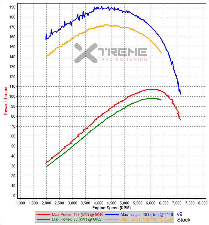

v9 Dynoes
Posted: Tue Aug 07, 2012 12:36 am
v9 3rd Gear Dynoes SAE.png (32.88 KiB) Viewed 25831 times

by turner_822
The car felt even faster! It was hauling when I first set off with the intake temp around 18 degrees. Then it stabilized at about 23-25 degrees but it was still going really well. I noticed in particular how it behaved when cruising in 5th gear at 100km/hr. It sits at about 2600rpm and when I put my foot down it instantly starts picking up speed and pulls up hills really well. It has this real surge between 2500-3000rpm that was definitely not there before, in fact it used to feel like crap when you put your foot down in that rpm range but now its great!!
I can't get over the pull it has between 4-5000rpm. Going from 1500rpm, its a bit slow but then really picks up between 2500-3000rpm. Its a bit slow from 3000-4000 but then it takes off between 4000-5000 and that surge makes for my favourite part the car's performance.
Power seems to fade a bit as it gets higher (5000 up to 6500rpm) but it's still way better then it used to be. I absolutely love the howling noise the engine makes as it approaches 6500rpm, it says just when to change gear. I know its probably howling in pain and agony, but I don't push it that hard very often and my service intervals are now every 5000km or ~4 months (although recently I have been doing a lot of hard driving for logs...)
Biggest imporvement by far though is the low-mid range power, and I find it getting the better of me sometimes on roads that I know really well. It has made everyday driving 10x better. With a supercharger I will definitely be looking to upgrade my brakes to avoid those bowel clenching moments :shock:
To see the difference between stock and v9 still amazes me...especially considdering a stack of local places that basically told me I was an idiot and you can't improve on a so-called perfect stock tune...read the graphs and weep :wink: 98 kW - 108 kW and 172 Nm - 191 Nm.
Nice work Edward, improving on what many called "perfection" lol
v9 vs Stock - 3rd Gear Dyno SAE
Posted: Tue Aug 07, 2012 6:32 pm
v9 vs Stock - 3rd Gear Dyno SAE.png (31.29 KiB) Viewed 25830 times

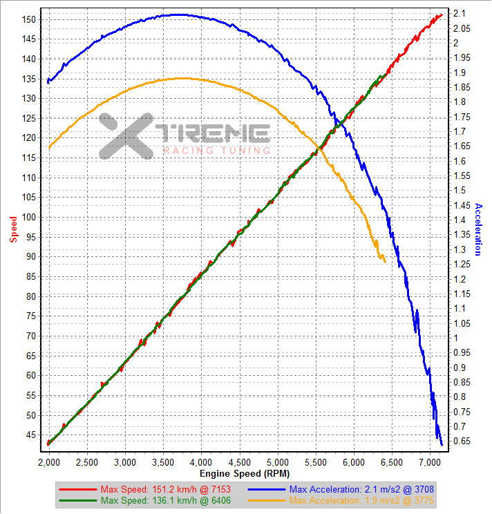

v9 Performance times.png (8.33 KiB) Viewed 25829 times
v9 Performance.png (32.53 KiB) Viewed 25829 times
