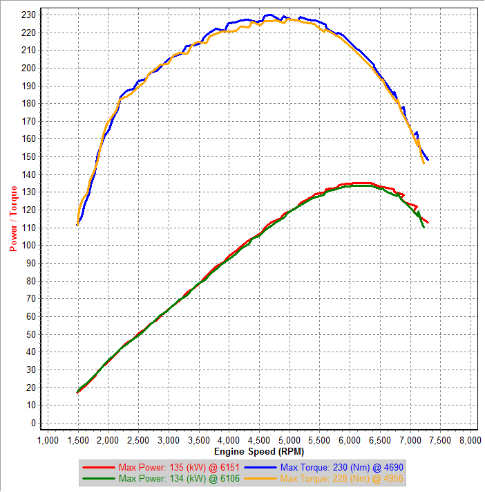

v11a Stats
Posted: Fri Jan 20, 2012 12:13 am
- v11a 3rd Gear Dynoes IAT=27-24C.png (23.3 KiB) Viewed 8082 times

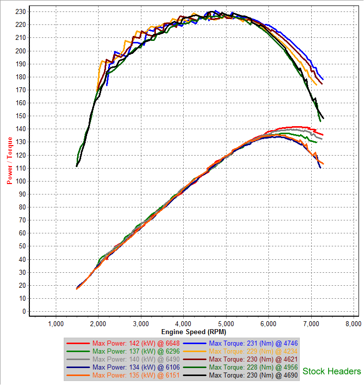

Raptor Headers v2
Posted: Fri Apr 06, 2012 8:33 am
- v11a 3rd Gear Dyno IAT=27-28C Headers vs Stock Headers.png (34.2 KiB) Viewed 8055 times

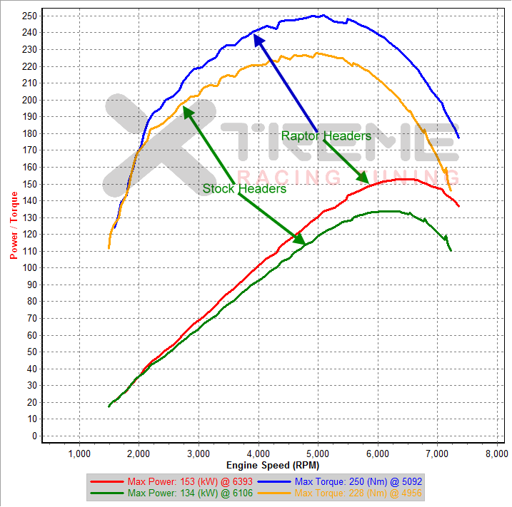

- v11c 3rd Gear Dyno - Raptor Header vs Stock Header
- v11c 3rd Gear Dyno - Raptor Header vs Stock Header.png (53.45 KiB) Viewed 7597 times
