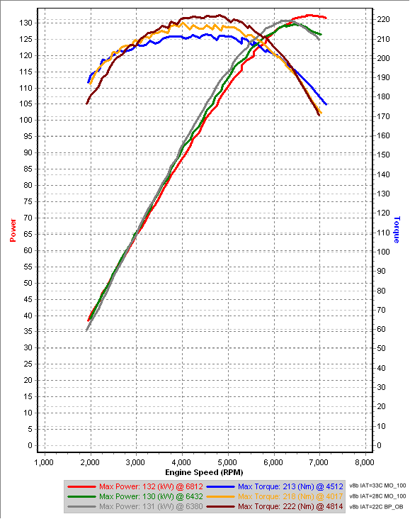

v8b - BP Octane Booster vs Mogas 100
I Think I like Mogas 100 since it was tested in hot weather and produce good results.
v8b 3rd Gear Dyno BP_OB vs MO_100.png (22.14 KiB) Viewed 18258 times

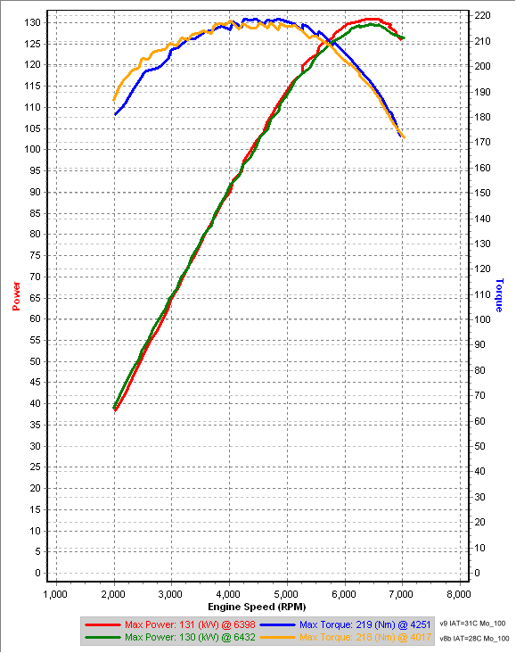

v9 vs v8b
V9 with new fuel map runs better at higher IAT temperature. Readjusted to increase tq below 3000rpm below.
Mogas is 100Octane with 5% Ethanol and easily attainable. I really think is 100Octane overall.
v9 vs v8b 3rd Gear Dyno Mo_100.png (20.49 KiB) Viewed 18257 times

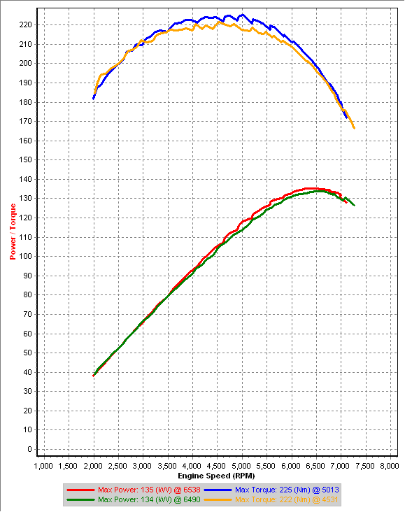

v9 and v9a
V9 & v9a. V9a posted higher figures. Really due to temperature. Release v9b which contains just minor AVCS change and tuning is completed.
v9 3rd Gear Dynoes IAT=27-24C Mo_100.png (15.81 KiB) Viewed 18252 times
