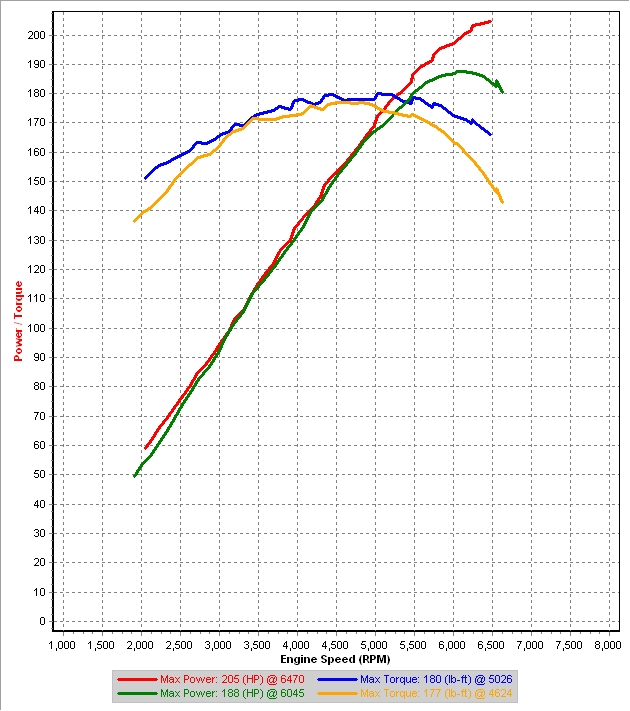

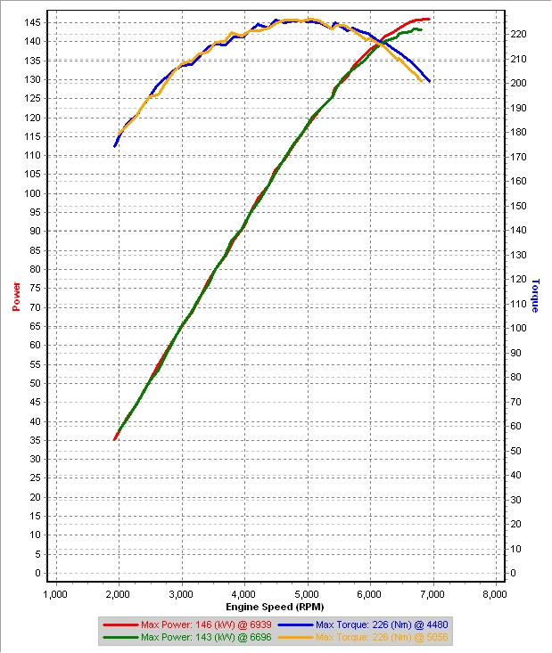

V0 Driving Stats. Finding rom completed.
V0 Dyno Stats
Posted: Sat Dec 05, 2009 8:24 am
Higher or Blue/Red lines are v0 dyno'es.
Fueling is still close to 14.7AFR before the car shifts to Normal mode. Once this can be rectify, I will see if the torque will come up before 2500rpm. AVCS has not be adjusted yet and will not be until the fueling is finished.
Some dyno runs were affected a bit due to ignition being pulled due to pinging and maybe old spark plugs.
- v0 vs Stock - 1st Gear Dyno.jpg (340.13 KiB) Viewed 17761 times
- v0 vs Stock - 3rd Gear Dyno #1.jpg (271.02 KiB) Viewed 17761 times
- v0 vs Stock - 3rd Gear Dyno #2.jpg (351.28 KiB) Viewed 17761 times
- v0 vs Stock - 4rd Gear Dyno #1.jpg (268.95 KiB) Viewed 17761 times

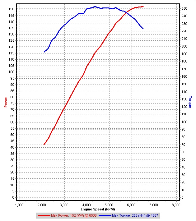

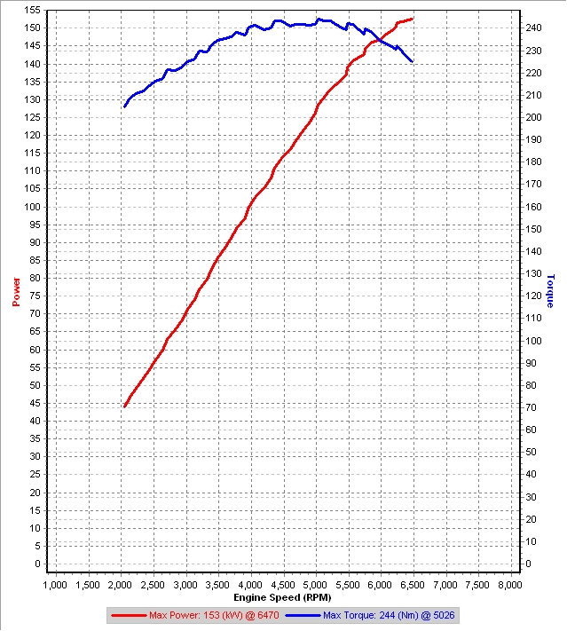

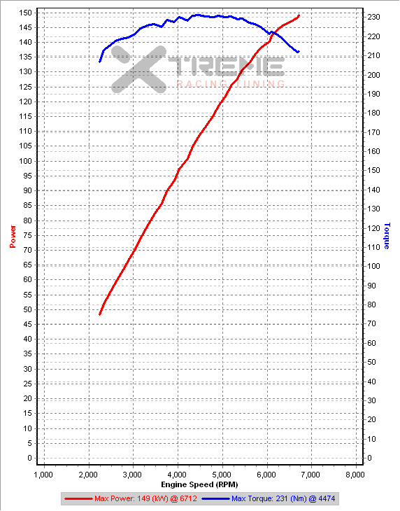

Dynoes in KW and Nm
Software dyno'es based on rpm. Speed dyno's are 10units less.
- v0 3rd Gear Dyno @ IAT=23C kw.jpg (199.46 KiB) Viewed 17757 times
- v0 4th Gear Dyno @ IAT=22C kw.jpg (331.43 KiB) Viewed 17757 times

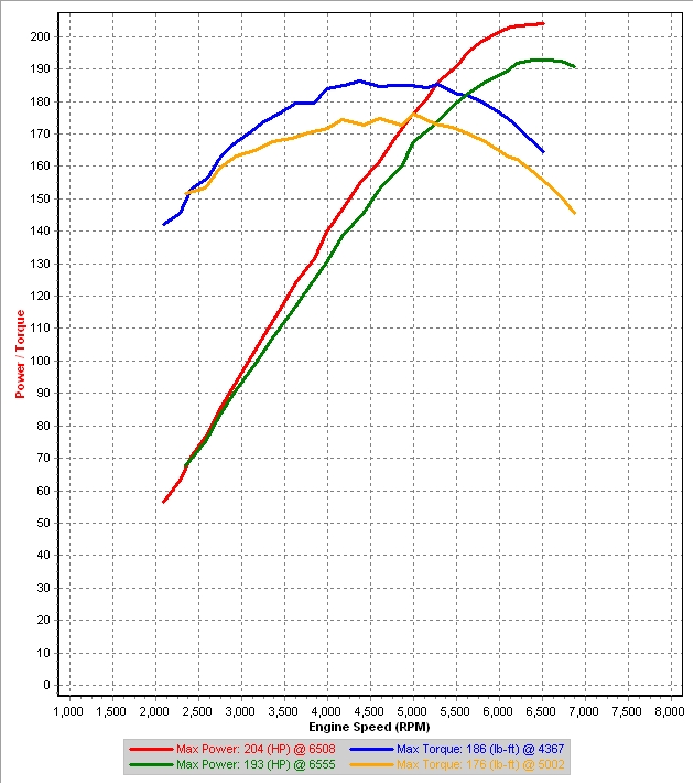

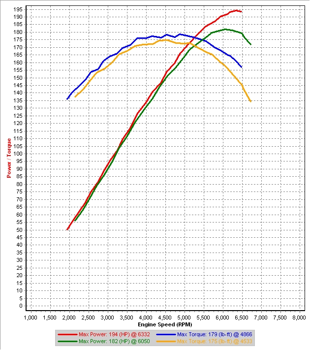

v0 vs stock mod vs stock - 3rd Gear Dyno's comparison
Posted: Sat Dec 05, 2009 10:09 pm
v0 vs stock mod vs stock - 3rd Gear Dyno's comparison @ Temperatures less than 24C

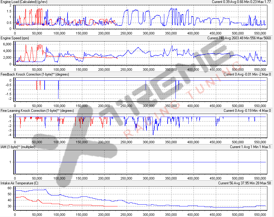

v1 Driving Stats
Posted: Sun Dec 06, 2009 7:52 am
v1 Driving Stats
V1 vs V0 vs Stock Driving Stats
Posted: Sun Dec 06, 2009 8:53 am

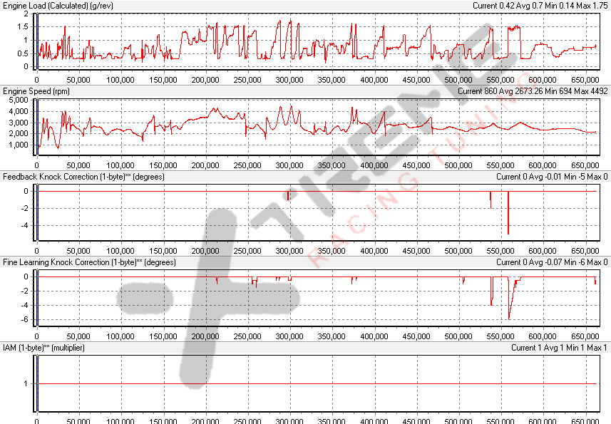

v4a Stats
Posted: Thu Dec 10, 2009 1:05 am
v4a Stats
- v4a Critical Stats.png (76.03 KiB) Viewed 17751 times

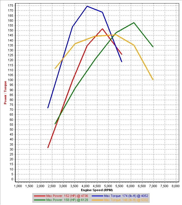

v4a 3rd Gear Dynos - IAT=30.5C to 31.5C
- v4a 3rd Gear Dyno.jpg (311.17 KiB) Viewed 17751 times

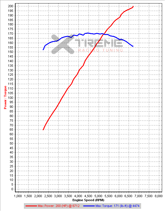

v5b Stats
Posted: Sat Dec 12, 2009 5:04 pm
v5b Stats
- v5b Driving Stats.png (61.63 KiB) Viewed 17742 times
- 5b 3rd Gear Dynos @ IAT=25C.png (18.01 KiB) Viewed 17742 times
- 5b 3rd Gear Dynos @ IAT=25C kw.png (19.65 KiB) Viewed 17742 times
