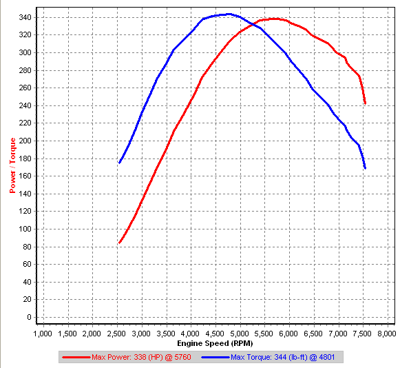

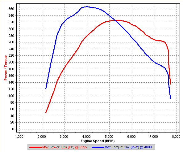

Below is the power to the wheel in the light GC8 body.
- Attachments
- Stg2-4 4th Gear Dyno #2 @ IAT=23-17C
- stg2-4 4th gear Dyno #2.png (11.58 KiB) Viewed 8807 times
- Stg2-4 4th Gear Dyno #1 @ IAT=29-19C
- stg2-4 4th gear Dyno.png (12.2 KiB) Viewed 8807 times

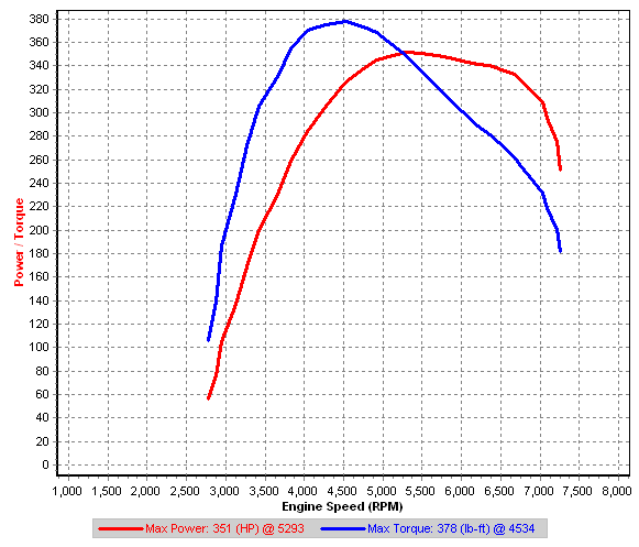

At present, the Water injection is faulty and sent for repairs. Noting that, the follow dyno is on the same car, but without water intection. All on the stock ECU, 21psi Wastegate and detuned to run at 22psi.
- Attachments
- S2-23 Dyno
- s2-23+.png (11.17 KiB) Viewed 8805 times
