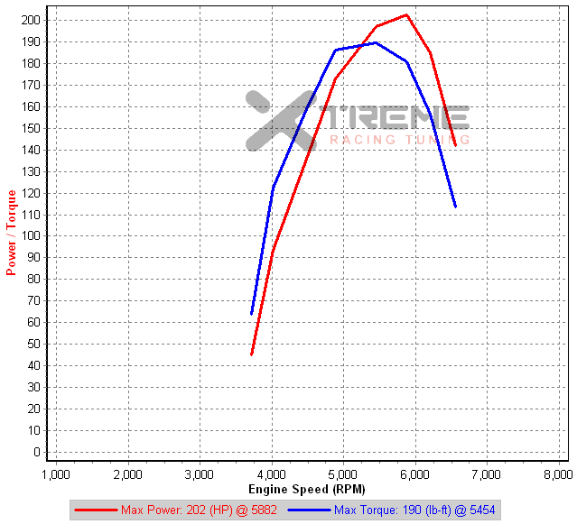

XRT_S2-VF39_v13 - 1st Gear Dyno IAT=18C.png (16.71 KiB) Viewed 19361 times

I thought it was feeling pretty quick, not bad power for home modified by myself and tuned remotely by Edward.
Next mods are bigger header cross pipe, possibly bigger intercooler.
very happy with power,maybe more to come!! thanks Edward.
