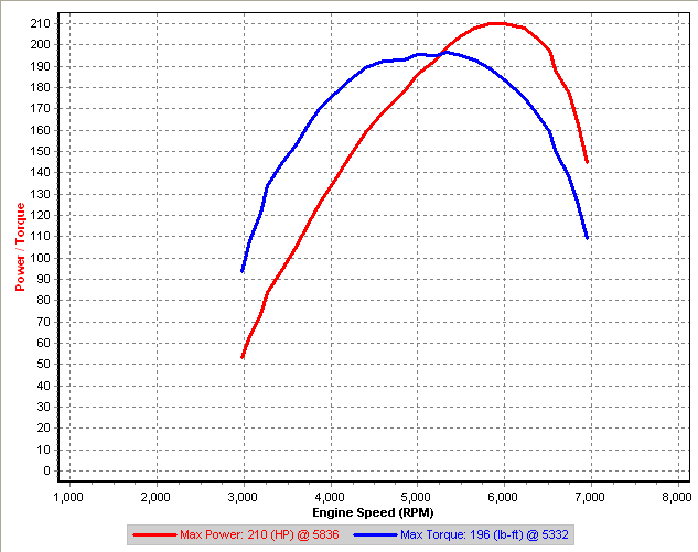

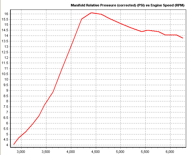

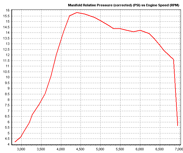

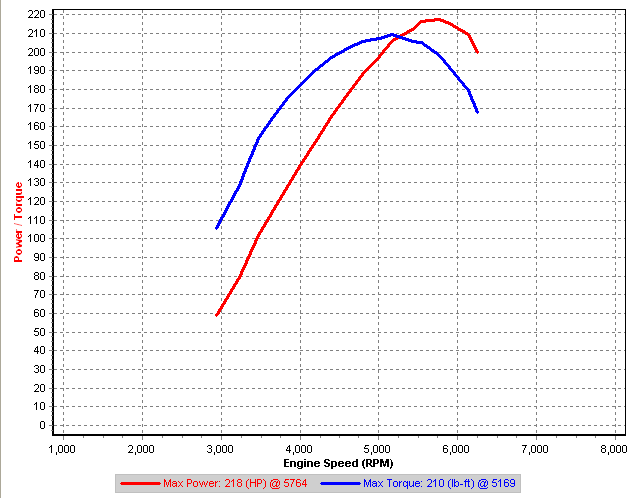

No mods. Car is totally stock.
Boost on these cars are set to 16psi.
Stock Road Dyno Boost - IAT=35, boost=16.1psi.png (9.12 KiB) Viewed 7330 times
Stock Road Dyno - IAT=35, boost=16.1psi.png (10.07 KiB) Viewed 7330 times
Stock Road Dyno Boost - IAT=40, boost=15.8psi.png (9.97 KiB) Viewed 7330 times
Stock Road Dyno - IAT=40, boost=15.8psi.png (10.57 KiB) Viewed 7328 times

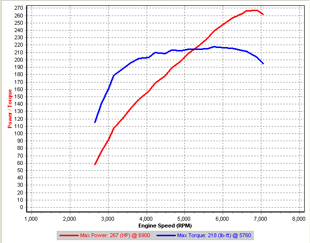

Car has a Turboback exhaust system and a BOV valve which makes the car runs rich when in use. It was not recir.
This tune felt very great. Good tq and very good hp. All results are to the wheel.
The car really suits the owner. Not aggressive rush, but constant linear fun.
IAT=40C, Boost 19psi
v1-11 Road Dyno IAT=40C, Boost=19psi.png (10.47 KiB) Viewed 7377 times
